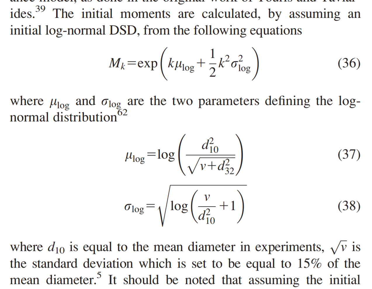

    @东岳 求教下 fluent 中qmom方法中入口的moment-0,moment-1。。。moment-5等等怎么设置和计算。麻烦了
    Li, D., Gao, Z., Buffo, A., Podgorska, W., Marchisio, D. L. (2017). Droplet breakage and coalescence in liquid–liquid dispersions: Comparison of different kernels with EQMOM and QMOM. AIChE Journal, 63, 2293-2311.
    给定直径d和v,依据37,38计算相应的mu和sigma,然后通过36计算矩。

    alleny
    @东岳 多谢!!
