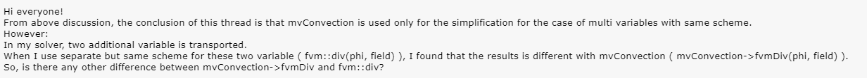

    并且cfd-online中也有人指出:
    “When I use separate but same scheme for these two variable ( fvm::div(phi, field) ), I found that the results is different with mvConvection ( mvConvection->fvmDiv(phi, field) ).”
    所以或许mvConvection->fvmDiv(phi, Yi)和fvm::div有点区别,不知道您有没有研究过?

    这个看起来并不会导致区别。有可能cfd-online的用户没做特别仔细的判定吧。
