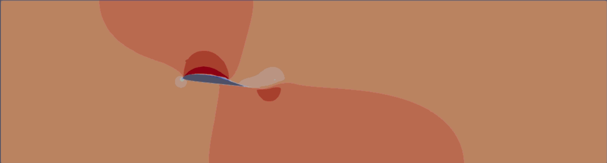

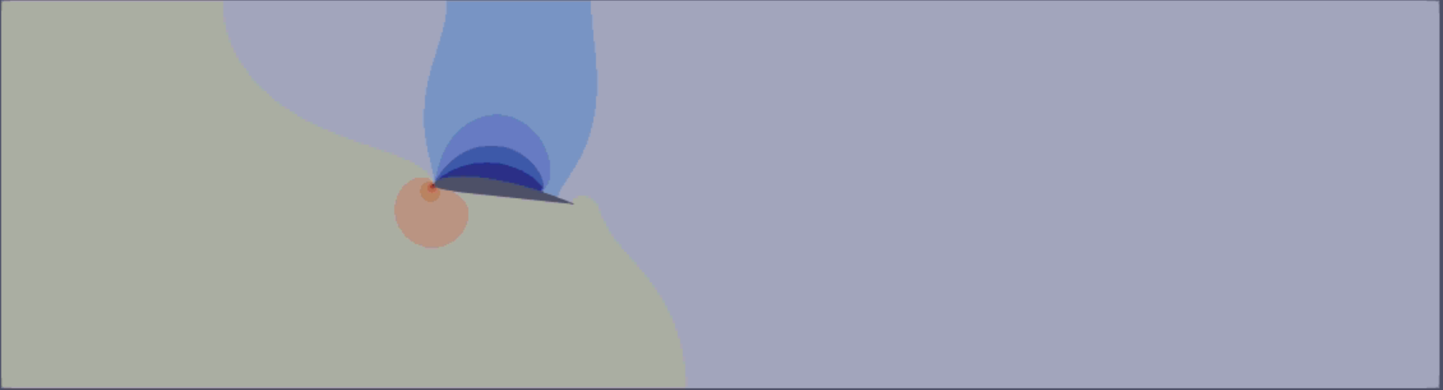

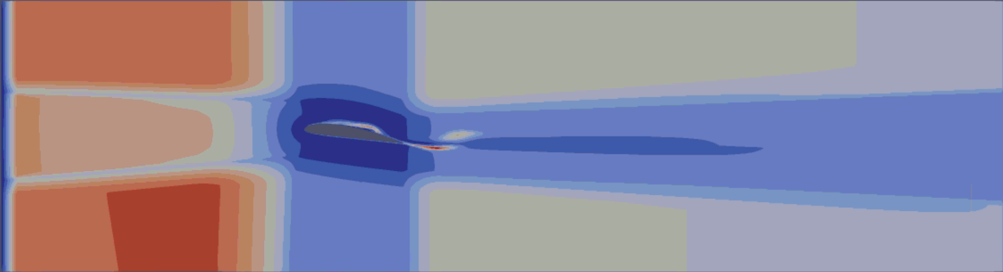

  • 粘度场异常
    C cavitazione.club
    1. 速度场
    2. 压力场
    3. 粘度场
    粘度边界:进出口calculated,机翼表面nutUSpaldingWallFunction,上下边界symmetry简化问题
    计算收敛,domainminandmax监测稳定无震荡
    求解器:default interPhaseChangeFoam,ofv1912
    湍流模型:kEqn LES
    粘度场异常原因?
