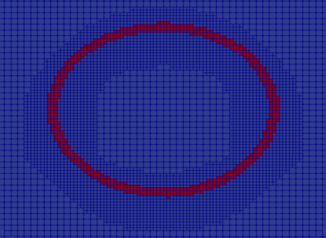

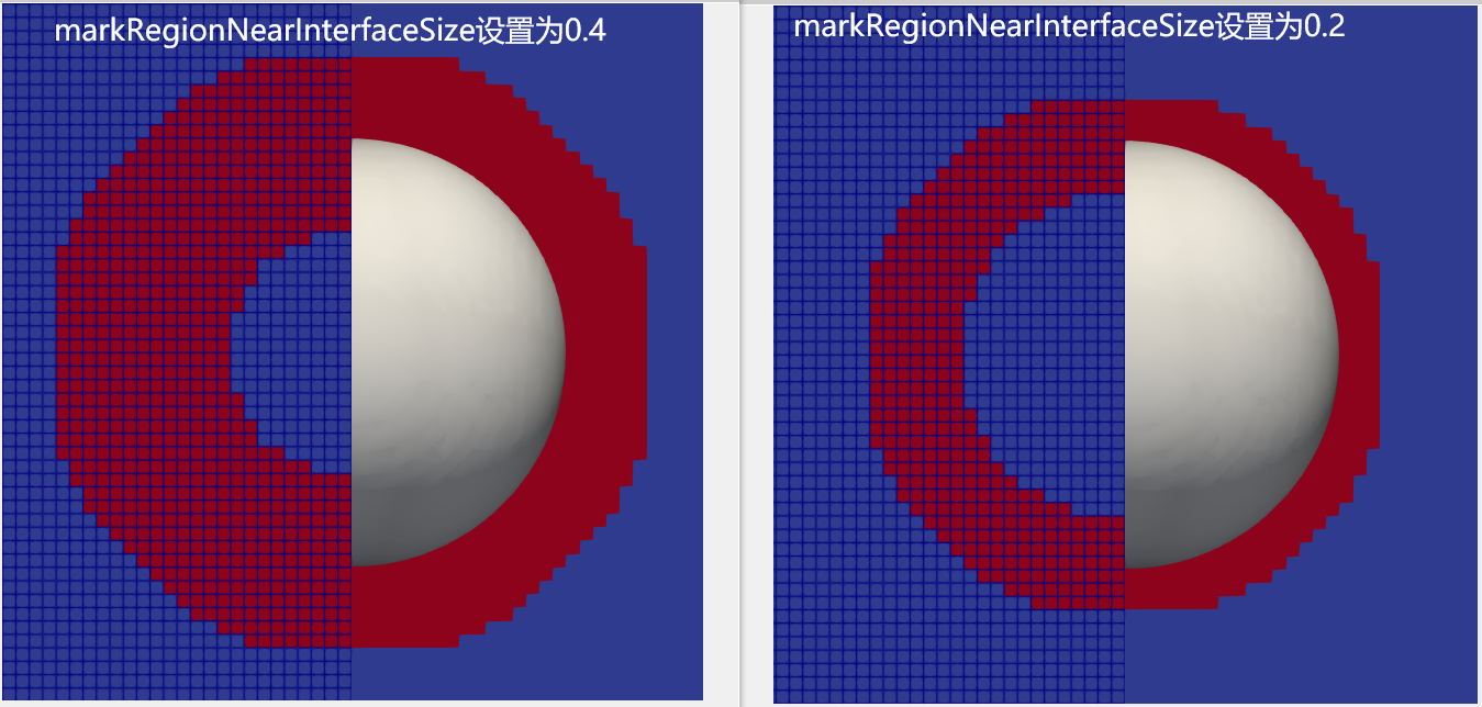

    大家好,我来更新这个问题的相关进展。最近两天我查了些资料,基本上解决了这个问题,感谢大家的帮助,尤其是bestucan大佬。
    参考帖子关于相邻cell我写了个遍历进行暴力求解。
    (1)代码思路:对所有网格做遍历,找到气液界面网格,针对每一个气液界面网格都对所有网格再做一次遍历,计算两网格之间的距离,对满足距离要求的网格在markRegionNearInterface这个场上+1。最后,可以利用markRegionNearInterface>=1来筛选出所有满足条件的网格。
    (2)这段代码计算起来实在是费时间,因为我的需求(见贴名)不需要每一个时间步都运行这段代码,所以我在代码最外层套了一个时间步判断,可以实现多个时间步运行一次该代码。
    (3)我从其他地方抄了点代码写了两个接口,分别从transportProperties读取 加密时间步间隔 和 加密范围,其中加密范围是依据气泡半径写的无量纲范围,所以需要配合前面代码(未在本段代码中给出)求出的气泡半径radius.value()定义标记区域。
    代码如下
    //read timestep interval required for the following code, as the following code is very time consuming so I needn't it run for every timestep.
    const label calculateTimestepInterval = transportProperties.get<label>("calculateTimestepInterval");
    //read information from transportProperties so that we can modify the size of marked region easily.
    scalar markRegionNearInterfaceSize = transportProperties.get<scalar>("markRegionNearInterfaceSize");
      if (mesh.time().timeIndex() % calculateTimestepInterval == 0)//judge whether the timestep satisfy the timestep interval criterion.
            markRegionNearInterface.field()=0;//reset the field to be zero first. Of course such field is claimed in createFields.H first.
            forAll(mesh.C(), i)//Cycle all meshes
                  if (alpha1[i]>0.0001&&alpha1[i]<0.9999)//judge whether the cell contains gas-liquid interface
                        vector centerOfSurfacePoint = mesh.C()[i];//store center information of such a interface cell
                        forAll(mesh.C(), cellI)//Cycle all meshes again
                               scalar offset = mag(centerOfSurfacePoint - mesh.C()[cellI]);//distance between any cells and the interface cell
                               if (offset <= markRegionNearInterfaceSize*radius.value())//judge the criterion, note the radius is calculated before with code which is not shown here
                                     markRegionNearInterface.field()[cellI] += 1;//any cells which meet the criterion will be marked with value>0
    运行结果如下

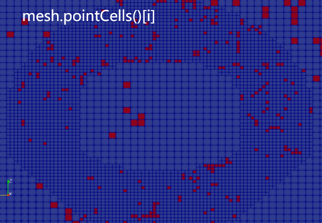

    @bestucan 对了大佬,我还碰到了一个小小的问题:
    @ir77 在 标记气液界面附近一定距离的网格用于自适应网格加密 中说:
    const labelList& neighbour = mesh.cellCells()[i];
    scalar sumforinterface(0);
    forAll(neighbour, cellI)
    if (alpha1[neighbour[cellI]]>0.0001&&alpha1[neighbour[cellI]]<0.9999)
    sumforinterface += 1;
    else
    sumforinterface += 0;
    if (sumforinterface>0)
    regionforinterface.field()[i]=1;
    else
    regionforinterface.field()[i]=0;

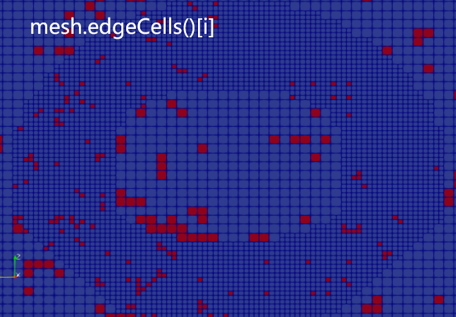

    我把这段代码第一句中的mesh.cellCells()[i]分别改成了mesh.pointCells()[i]和mesh.edgeCells()[i],运行结果却非常糟糕(如下图),似乎只有mesh.cellCells()[i]才可以正常使用。
    大佬您能从经验上帮我判断一下可能是哪里出错了吗:xiexie:

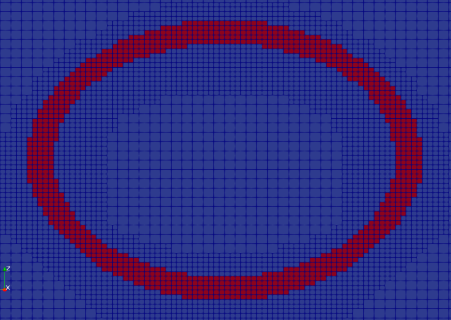

    后来我在cfdonline上找到了一条和我问题类似的帖子。参照18楼的代码完成了代码修改,实现了对气液界面附近的更多网格的标记。
    代码放在下面,供大家参考,我是初学者,代码写的不规范,大家见谅:134:

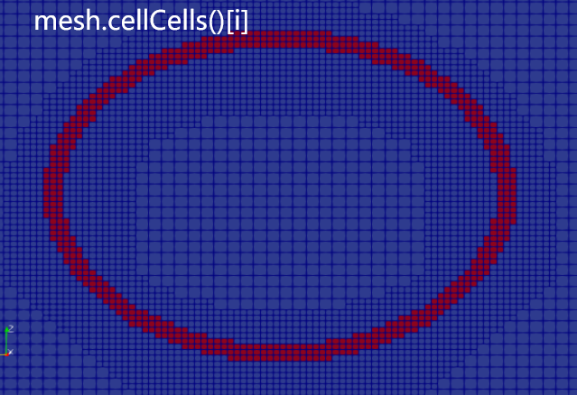

    @bestucan 多谢大佬费心,我昨天也看到了这个帖子,昨天我参照这个帖子做出了一个初级版本,能够实现对气液界面附近三层网格的标记。2823d79e-f63b-4bcf-b360-454da4c63dac-image.png
    我采用的代码是这样的:
              scalar sum(0);
                sum += alpha1[neighbour[cellI]];
              sum /= neighbour.size();
            if (sum>0.0001&&sum<0.9999)
            else

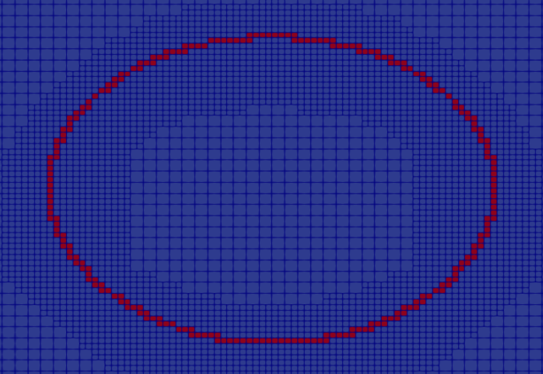

    @bestucan bestucan大佬您好,我的那几行代码,仅能实现对气液界面单层网格的标记(如下图的红色网格,代表标记值1),但是我想要标记气液界面附近的多层网格:比如界面的内部5层外部5层的网格我都想把它标记下来。大佬您有相关建议吗:xinxin:

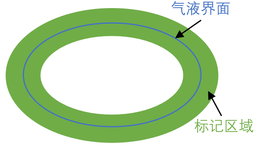

    李老师及各位大佬好:.
    我想要用自适应网格加密气液界面。
    但不想按照常规AMR做法,仅加密0.001<α<0.999的网格,因为这样仅能加密气液界面的几层网格,我想多加密一些气液界面的网格。我考虑:能否定义一个标量场(例如该场名为regionforrefine),标记气液界面附近一定距离的网格,将这些网格的regionforrefine赋值为1,其他网格regionforrefine赋值为0,然后在dynamicMeshdict里指定加密0.5<regionforrefine<1.5的网格。我想这样就能多加密一些气液界面的网格(如图)
    目前小弟在求解器的C文件里写了下面这一些代码,仅仅能够实现将气液界面单独标记出来,但如何将标记区域向内和向外扩张,我没有一点思路。
