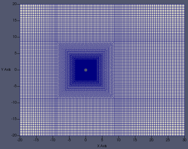

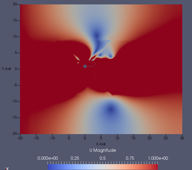

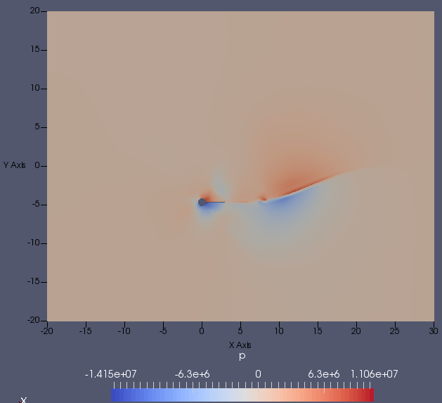

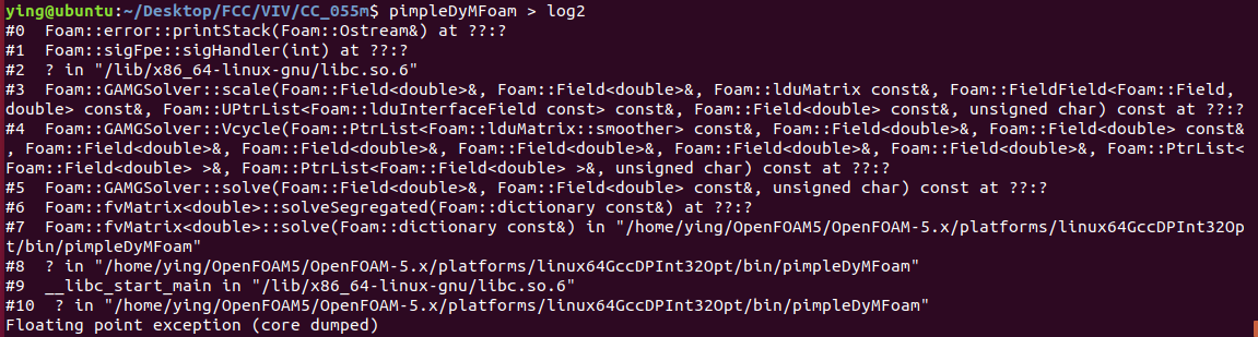

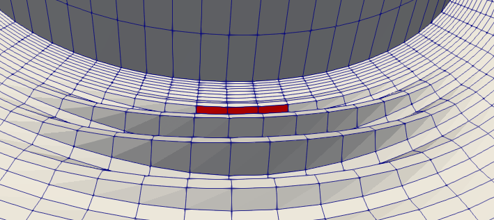

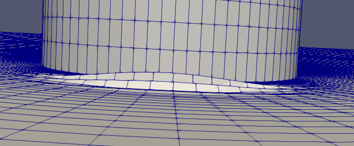

    各位老师好,我使用pimpleDyMFoam计算钝体涡激振动时,算例的CFL越来越大并计算一段时间后发散。通过查看速度和压力场,发现一开始就不太正常,然后随着时间推移,误差逐渐积累最后发散。报错如下:
    #1  Foam::sigFpe::sigHandler(int) at ??:?
    #2  ? in "/lib/x86_64-linux-gnu/libc.so.6"
    #3  Foam::GAMGSolver::scale(Foam::Field<double>&, Foam::Field<double>&, Foam::lduMatrix const&, Foam::FieldField<Foam::Field, double> const&, Foam::UPtrList<Foam::lduInterfaceField const> const&, Foam::Field<double> const&, unsigned char) const at ??:?
    #4  Foam::GAMGSolver::Vcycle(Foam::PtrList<Foam::lduMatrix::smoother> const&, Foam::Field<double>&, Foam::Field<double> const&, Foam::Field<double>&, Foam::Field<double>&, Foam::Field<double>&, Foam::Field<double>&, Foam::Field<double>&, Foam::PtrList<Foam::Field<double> >&, Foam::PtrList<Foam::Field<double> >&, unsigned char) const at ??:?
    #5  Foam::GAMGSolver::solve(Foam::Field<double>&, Foam::Field<double> const&, unsigned char) const at ??:?
    #6  Foam::fvMatrix<double>::solveSegregated(Foam::dictionary const&) at ??:?
    #7  Foam::fvMatrix<double>::solve(Foam::dictionary const&) in "/home/ying/OpenFOAM41/OpenFOAM-4.1/platforms/linux64GccDPInt32Opt/bin/pimpleDyMFoam"
    #8  ? in "/home/ying/OpenFOAM41/OpenFOAM-4.1/platforms/linux64GccDPInt32Opt/bin/pimpleDyMFoam"
    #9  __libc_start_main in "/lib/x86_64-linux-gnu/libc.so.6"
    #10  ? in "/home/ying/OpenFOAM41/OpenFOAM-4.1/platforms/linux64GccDPInt32Opt/bin/pimpleDyMFoam"
    Floating point exception (core dumped)

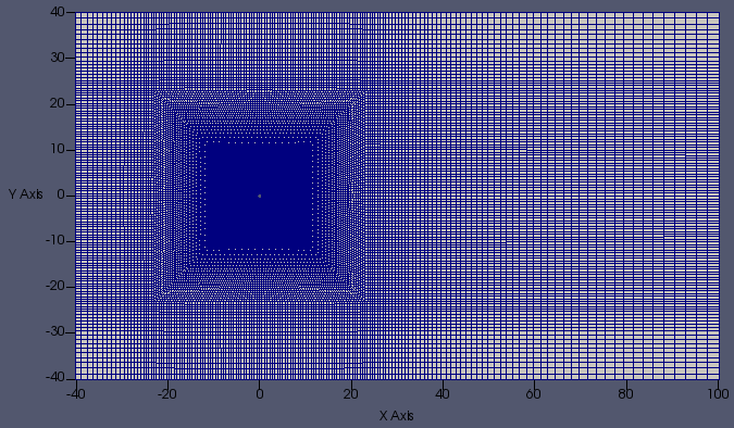

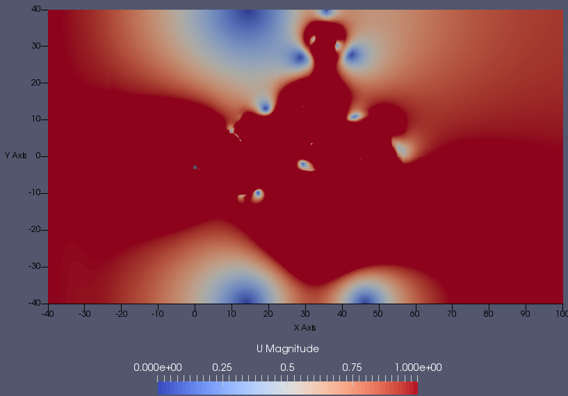

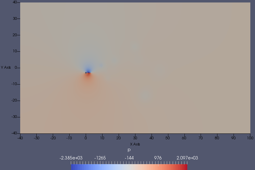

    我查了一下有人说很可能是网格或边界条件的问题。我的边界条件是比较基础的速度入口/压力出口,感觉应该没问题;我也使用了refine的网格重新计算,发现crash的时间延长了,但速度场和压力场还是一开始就不正确。两种网格质量都没问题。
    我附加了我的算例设置文件,和流场图以供参考。
    1. 粗网格及流场
    2. 细网格及流场
    3. 边界条件(U/p/pointDisplacement)

    请各位老师帮忙看看是什么问题,困扰好久了。。。谢谢!

    各位老师好,我在OF7中使用 dynamicMotionSolverFvMesh 和 sixDoFRigidBodyMotion 计算三维圆柱的涡激振动问题。圆柱直径D=1m,预计振幅0.6D左右,遇到问题如下:
    1. 圆柱振动到0.2D左右时,算例会突然崩掉,报错:
      4649ed61-38ff-42bd-ae45-64418d0fd3d8-image.png 此时CFLmax=0.7,流场也比较正常,应该是还没来得及崩溃。
    2. 通过checkMesh发现计算域底面有几个网格(标红)的skewness非常大,这应该是导致失败的原因:
      1313f674-74b7-4ae4-bd95-4ed745e61b30-image.png 此时圆柱是向+y轴运动,不太明白为什么靠近圆柱(-y轴方向)的这几层网格会凸起。因为这个范围属于设置的inner Distance之内,按理说网格是不变形的,而是直接随圆柱运动。(目前设置是 inner Distance = 1.5m, outer Distance = 2.5m)
    请问有人遇到过类似问题吗?第一次遇到这个情况。。。怎么调都没用
