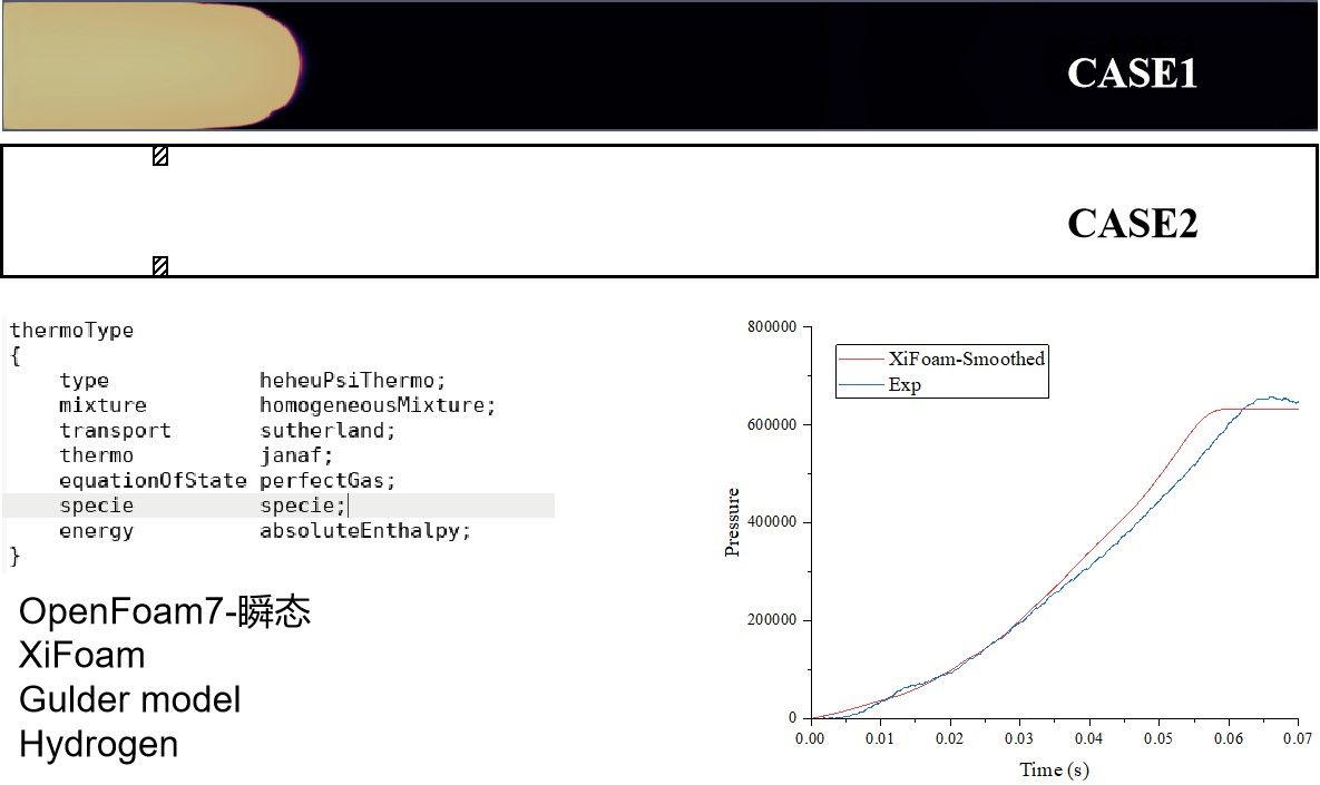

    求助,最近基于blastReactingFoam进行气体爆炸计算,但是得到的爆炸超压震荡非常厉害,与实际显然有出入,感觉可能是离散格式设置不合理,这一块找不到什么资料进行参考修改。各位大佬可否给予指点。
    基本设置如下
    求解器:blastReactingFoam,湍流模型:k-omega SST
    网格:二维,全正交网格,网格尺寸0.5 mm
        \\  /    A nd           | Version:  7
         \\/     M anipulation  |
    FoamFile
        version     2.0;
        format      ascii;
        class       dictionary;
        location    "system";
        object      fvSchemes;
    fluxScheme      Kurganov;
    ddtSchemes
        default         CrankNicolson 1;//Euler;
        timeIntegrator  RK2SSP;
    gradSchemes
        default         Gauss linear;
        grad(U)         cellLimited leastSquares 1;
        grad(k)         cellLimited leastSquares 1;
        grad(epsilon)   cellLimited leastSquares 1;
        grad(omega)     cellLimited leastSquares 1;
    divSchemes
        default         bounded Gauss linearUpwind limited;
        div(tauMC)      Gauss linear;
        div(rhoPhi,U)       Gauss linearUpwind grad(U);
        div(rhoPhi,Yi_h)   Gauss MUSCL;
        div(rhoPhid,p)     Gauss linearUpwind grad(U);
        div(rhoPhi,K)      Gauss limitedLinear 0.5;//
        div(rhoPhi,omega)     Gauss linearUpwind default;
        div(((rho*nuEff)*dev2(T(grad(U))))) Gauss linear;
    laplacianSchemes
        default         Gauss linear orthogonal;
    interpolationSchemes
        default         linear;
        reconstruct(rho) vanLeer;
        reconstruct(U)  vanLeerV;
        reconstruct(h)  vanLeer;
        reconstruct(e)  vanLeer;
        reconstruct(p)  vanLeer;
        reconstruct(speedOfSound)  vanLeer;
    snGradSchemes
        default         orthogonal;
    wallDist
        method meshWave;

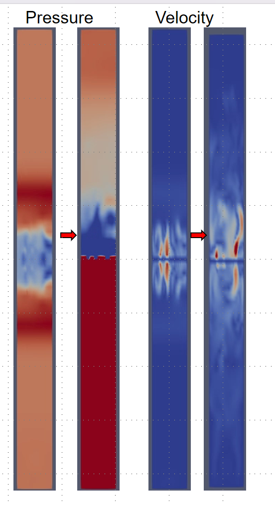

    需求:在一个管子中间有一个阀门,压力大于一定值后阀门打开
    我在李东岳老师的建议下尝试使用activePressureForceBaffleVelocity/activeBaffleVelocity边界条件实现上述功能。查阅资料发现实现该功能需要在目标位置创建4个面(两个wall,两个cyclic),经过许多尝试,代码能够运行不报错,但是结果有明显问题。初始时刻的各种场出现诡异变化,如图所示。部分关键文件进行上传,请大佬帮忙指正错误。p.orig T.orig U.orig blockMeshDict createBafflesDict createPatchDict topoSetDict
