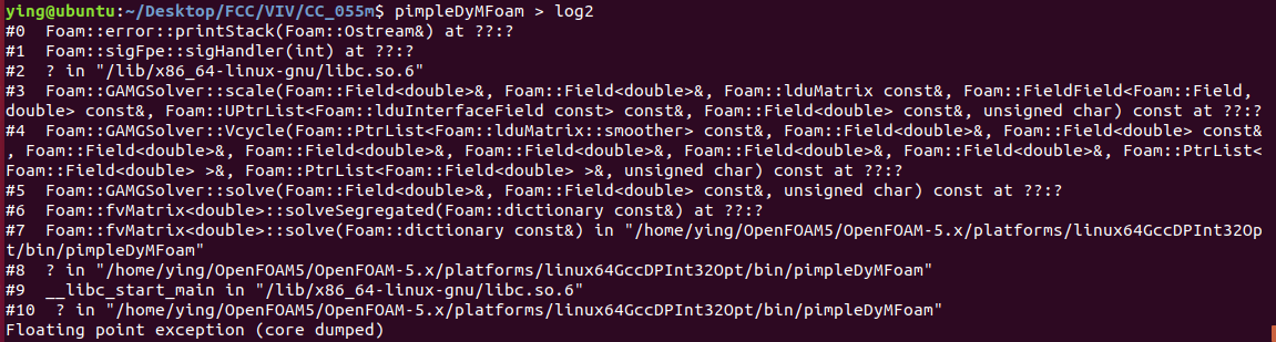

各位老师好,我使用pimpleDyMFoam计算钝体涡激振动时,算例的CFL越来越大并计算一段时间后发散。通过查看速度和压力场,发现一开始就不太正常,然后随着时间推移,误差逐渐积累最后发散。报错如下:
#0 Foam::error::printStack(Foam::Ostream&) at ??:?
#1 Foam::sigFpe::sigHandler(int) at ??:?
#2 ? in "/lib/x86_64-linux-gnu/libc.so.6"
#3 Foam::GAMGSolver::scale(Foam::Field<double>&, Foam::Field<double>&, Foam::lduMatrix const&, Foam::FieldField<Foam::Field, double> const&, Foam::UPtrList<Foam::lduInterfaceField const> const&, Foam::Field<double> const&, unsigned char) const at ??:?
#4 Foam::GAMGSolver::Vcycle(Foam::PtrList<Foam::lduMatrix::smoother> const&, Foam::Field<double>&, Foam::Field<double> const&, Foam::Field<double>&, Foam::Field<double>&, Foam::Field<double>&, Foam::Field<double>&, Foam::Field<double>&, Foam::PtrList<Foam::Field<double> >&, Foam::PtrList<Foam::Field<double> >&, unsigned char) const at ??:?
#5 Foam::GAMGSolver::solve(Foam::Field<double>&, Foam::Field<double> const&, unsigned char) const at ??:?
#6 Foam::fvMatrix<double>::solveSegregated(Foam::dictionary const&) at ??:?
#7 Foam::fvMatrix<double>::solve(Foam::dictionary const&) in "/home/ying/OpenFOAM41/OpenFOAM-4.1/platforms/linux64GccDPInt32Opt/bin/pimpleDyMFoam"
#8 ? in "/home/ying/OpenFOAM41/OpenFOAM-4.1/platforms/linux64GccDPInt32Opt/bin/pimpleDyMFoam"
#9 __libc_start_main in "/lib/x86_64-linux-gnu/libc.so.6"
#10 ? in "/home/ying/OpenFOAM41/OpenFOAM-4.1/platforms/linux64GccDPInt32Opt/bin/pimpleDyMFoam"
Floating point exception (core dumped)

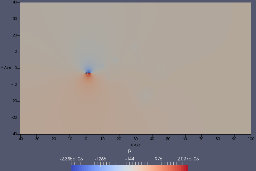

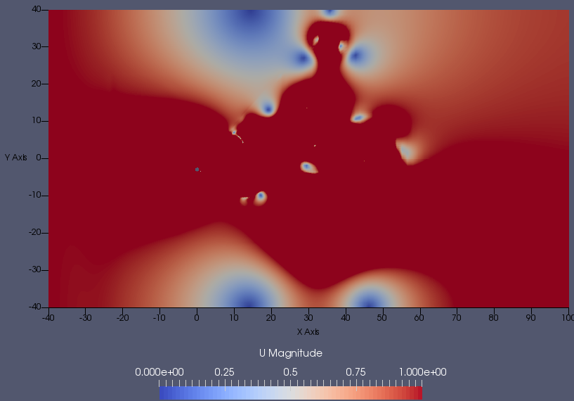

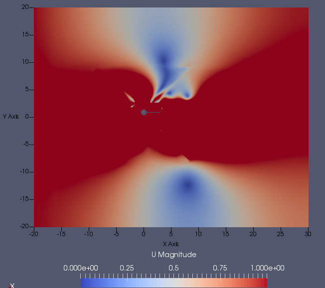

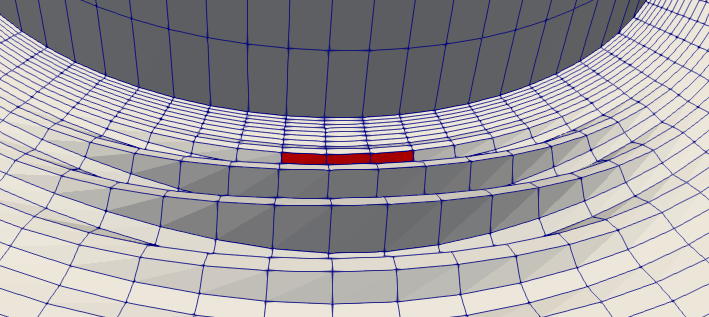

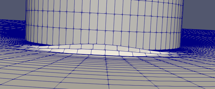

我查了一下有人说很可能是网格或边界条件的问题。我的边界条件是比较基础的速度入口/压力出口,感觉应该没问题;我也使用了refine的网格重新计算,发现crash的时间延长了,但速度场和压力场还是一开始就不正确。两种网格质量都没问题。
我附加了我的算例设置文件,和流场图以供参考。
粗网格及流场
细网格及流场
