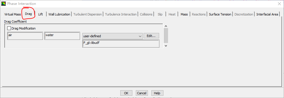

    fluent默认模型收敛,修改后直接发散。提示:
    Updating solution at time level N... done.

    @东岳 计算了新的曳力系数
