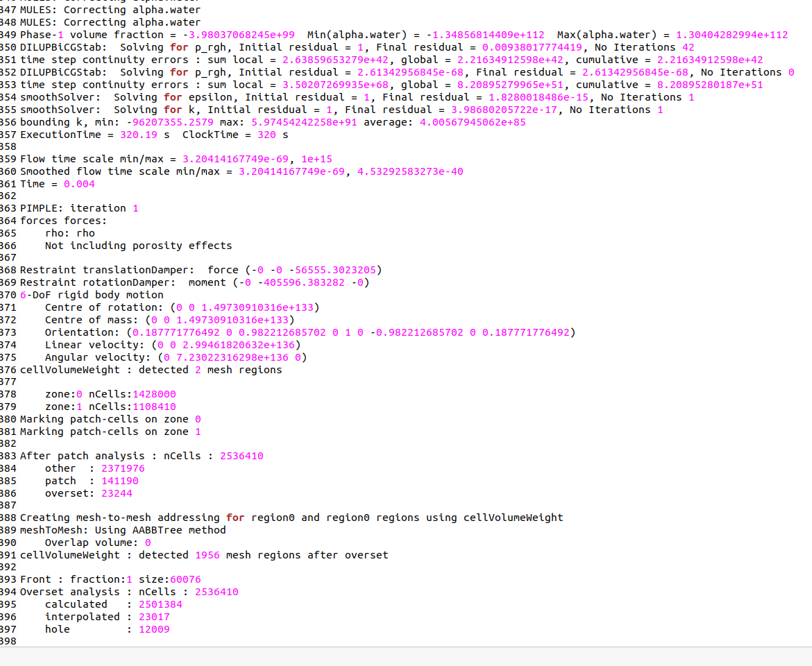

    @一朵苍凉 不知道您能不能帮我看下我的算例,看看那儿可以优化以下?我的算例是重叠网格进行自由运动计算。运算几步以后就崩了,运动不对,但不知道那儿存在问题,可以的话,我上传详细的细节给您。1.png 2.png
    一 1 条回复 最后回复
  • 一 离线
    一 离线
    一朵苍凉
    在 中回复了 souliam 最后由 编辑
    @souliam
    运行很快崩溃的话,可能是存在非常致命的问题。首先确保网格是mesh ok的,然后确保物体的几何属性例如质量惯性矩这些都没问题,如果还是很快crash的话,可以适当增大pimple求解的外循环次数。

    @一朵苍凉 这个算例我在商软starccm+里面已经算过,目前在openfoamv2012进行同样的计算。网格仿造DTChull算例,利用snappyHexMesh生成,我的求解文件输出是这样的,运动输出的6Dof结果感觉比较大,所以我认为可能是我的dynamicsMeshdict文件可能有问题,但不知道那儿有问题,您方便的话,再帮我看以下,指点一二,感谢。
    Create mesh for time = 0
    Selecting dynamicFvMesh dynamicOversetFvMesh
    Selecting motion solver: sixDoFRigidBodyMotion
    Applying solid body motion to entire mesh
    Selecting sixDoFSolver Newmark
    Translational constraint tensor (0 0 0 0 0 0 0 0 1)
    Rotational constraint tensor (1 0 0 0 1 0 0 0 1)
    PIMPLE: no residual control data found. Calculations will employ 2 corrector loops
    Using LTS
    Reading field p_rgh
    Reading field U
    Creating cellMask field to block out hole cells
    Creating interpolatedCells field
    Reading transportProperties
    Selecting incompressible transport model Newtonian
    Selecting RAS turbulence model kEpsilon
    RAS
    RASModel kEpsilon;
    turbulence on;
    printCoeffs on;
    Cmu 0.09;
    C1 1.44;
    C2 1.92;
    C3 0;
    sigmak 1;
    sigmaEps 1.3;
    Reading g
    Reading hRef
    Calculating field g.h
    No MRF models present
    DICPCG: Solving for pcorr, Initial residual = 1, Final residual = 9.39433050916e-07, No Iterations 467
    Reading/calculating face velocity Uf
    Starting time loop
    Flow time scale min/max = 8.6866267787e-07, 0.0291922459613
    Smoothed flow time scale min/max = 8.6866267787e-07, 0.0291922459613
    Time = 0.001
    PIMPLE: iteration 1
    forces forces:
    rho: rho
    Not including porosity effects
    Restraint translationDamper: force (-0 -0 -0)
    Restraint rotationDamper: moment (-0 -0 -0)
    6-DoF rigid body motion
    Centre of rotation: (0 0 -0.461009082997)
    Centre of mass: (0 0 -0.461009082997)
    Orientation: (0.999999999122 -4.18404783667e-05 2.19816547713e-06 4.18405388615e-05 0.999999998746 -2.75277355352e-05 -2.19701370075e-06 2.75278274834e-05 0.999999999619)
    Linear velocity: (0 0 0.0218340063689)
    Angular velocity: (0.0550532334843 0.00439510067628 0.0836815815307)
    cellVolumeWeight : detected 2 mesh regions
    zone:0 nCells:1428000
    zone:1 nCells:1108410
    Marking patch-cells on zone 0
    Marking patch-cells on zone 1
    After patch analysis : nCells : 2536410
    other : 2371976
    patch : 141190
    overset: 23244
    Creating mesh-to-mesh addressing for region0 and region0 regions using cellVolumeWeight
    meshToMesh: Using AABBTree method
    Overlap volume: 2.68136988135
    cellVolumeWeight : detected 3 mesh regions after overset
    Front : fraction:1 size:23970
    Overset analysis : nCells : 2536410
    calculated : 2512836
    interpolated : 23432
    hole : 142
    Execution time for mesh.update() = 56.91 s
    smoothSolver: Solving for alpha.water, Initial residual = 1.32501360637e-07, Final residual = 5.40621940608e-09, No Iterations 1
    Phase-1 volume fraction = 0.80497110631 Min(alpha.water) = 0 Max(alpha.water) = 1.00094392533
    MULES: Correcting alpha.water
    Phase-1 volume fraction = 0.804971106201 Min(alpha.water) = -5.22912457509e-16 Max(alpha.water) = 1.00094392533
    smoothSolver: Solving for alpha.water, Initial residual = 1.32287726888e-07, Final residual = 5.33117835751e-09, No Iterations 1
    Phase-1 volume fraction = 0.80497110685 Min(alpha.water) = -3.28734455684e-21 Max(alpha.water) = 1.00148843719
    Applying the previous iteration compression flux
    Phase-1 volume fraction = 0.804971106742 Min(alpha.water) = -3.32478347046e-14 Max(alpha.water) = 1.00148843719
    DILUPBiCGStab: Solving for p_rgh, Initial residual = 1, Final residual = 0.00904252579238, No Iterations 4
    time step continuity errors : sum local = 4.98432915358e-06, global = -4.35030739554e-09, cumulative = -4.35030739554e-09
    DILUPBiCGStab: Solving for p_rgh, Initial residual = 0.000104613428998, Final residual = 9.48129717208e-07, No Iterations 95
    time step continuity errors : sum local = 5.17819342099e-08, global = 9.75203425207e-09, cumulative = 5.40172685653e-09
    smoothSolver: Solving for epsilon, Initial residual = 0.00318321052028, Final residual = 5.00754349231e-05, No Iterations 2
    bounding epsilon, min: -0.00891808144257 max: 106.248958364 average: 1.03357845974
    smoothSolver: Solving for k, Initial residual = 0.999999999979, Final residual = 0.0989395295117, No Iterations 1
    PIMPLE: iteration 2
    smoothSolver: Solving for alpha.water, Initial residual = 1.5141031309e-05, Final residual = 5.25145730347e-09, No Iterations 2
    Phase-1 volume fraction = 0.804973015496 Min(alpha.water) = -7.90828268587e-26 Max(alpha.water) = 1.00074698501
    Phase-1 volume fraction = 0.804972981578 Min(alpha.water) = -0.000375075266952 Max(alpha.water) = 1.00074698501
    smoothSolver: Solving for alpha.water, Initial residual = 1.54146759159e-05, Final residual = 5.35120277128e-09, No Iterations 2
    Phase-1 volume fraction = 0.804974867545 Min(alpha.water) = -4.8534415386e-10 Max(alpha.water) = 1.0014871078
    Phase-1 volume fraction = 0.80497478029 Min(alpha.water) = -0.000141219315799 Max(alpha.water) = 1.0014871078
    DILUPBiCGStab: Solving for p_rgh, Initial residual = 3.91238817862e-05, Final residual = 9.99981139229e-07, No Iterations 15
    time step continuity errors : sum local = 1.97312896592e-06, global = 8.73490744761e-07, cumulative = 8.78892471617e-07
    DILUPBiCGStab: Solving for p_rgh, Initial residual = 6.95825944208e-06, Final residual = 8.05766273076e-07, No Iterations 19
    time step continuity errors : sum local = 1.37353052288e-06, global = -1.53311028217e-07, cumulative = 7.25581443401e-07
    smoothSolver: Solving for epsilon, Initial residual = 0.0476145055724, Final residual = 0.00249278364183, No Iterations 6
    bounding epsilon, min: -1.06527371456 max: 3100.56090246 average: 2.84781772564
    smoothSolver: Solving for k, Initial residual = 0.79259262557, Final residual = 0.0311989522415, No Iterations 4
    ExecutionTime = 112.02 s ClockTime = 112 s
    Flow time scale min/max = 1.85015907037e-06, 1e+15
    Smoothed flow time scale min/max = 1.85015907037e-06, 0.0296574788498
    Time = 0.002
    PIMPLE: iteration 1
    forces forces:
    rho: rho
    Restraint translationDamper: force (-0 -0 -187.685118747)
    Restraint rotationDamper: moment (-637.846763149 -50.9216364354 -969.534803614)
    Centre of rotation: (0 0 -0.459430003293)
    Centre of mass: (0 0 -0.459430003293)
    Orientation: (0.998240479028 -0.0584060732538 0.0102311601265 0.058508037056 0.998237177305 -0.00996731887657 -0.00963097244877 0.0105483862658 0.999897982755)
    Linear velocity: (0 0 3.13632540091)
    Angular velocity: (6.05745573944 18.6026037453 117.298982883)
    other : 2371976
    patch : 141190
    overset: 23244
    Overlap volume: 2.67649933669
    cellVolumeWeight : detected 4 mesh regions after overset
    Front : fraction:1 size:24277
    calculated : 2512742
    interpolated : 23425
    hole : 243
    Execution time for mesh.update() = 54.91 s
    [3] #0 Foam::error::printStack(Foam::Ostream&) at ??:?
    [3] #1 Foam::sigFpe::sigHandler(int) at ??:?
    [3] #2 ? in /lib/x86_64-linux-gnu/libpthread.so.0
    [3] #3 Foam::symGaussSeidelSmoother::smooth(Foam::word const&, Foam::Field<double>&, Foam::lduMatrix const&, Foam::Field<double> 一堆错误提示省略
    Primary job terminated normally, but 1 process returned
    a non-zero exit code. Per user-direction, the job has been aborted.
    mpirun noticed that process rank 3 with PID 0 on node dell-optiplex-7070 exited on signal 8 (Floating point exception).
    souliam

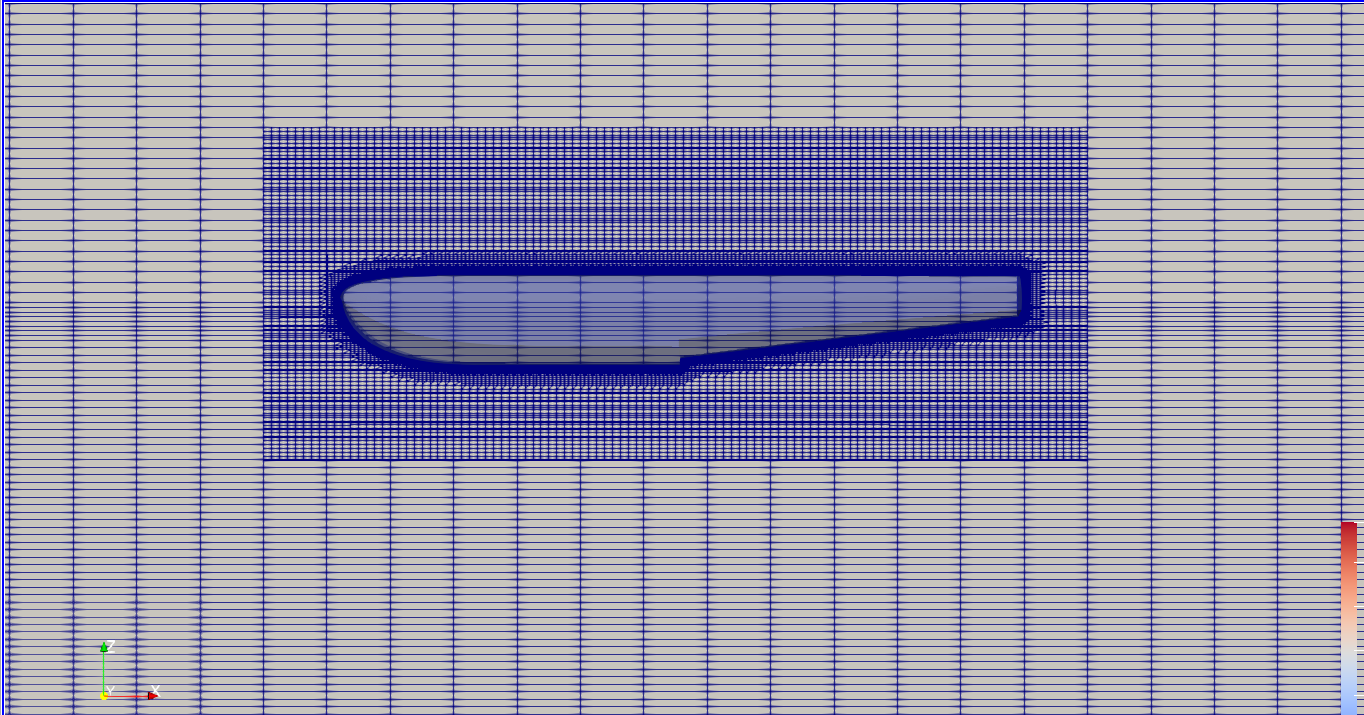

    @souliam 看起来你释放了一个平动和三个转动,不确定你的惯性矩等几何参数设置是否正确。为什么浮体网格表面看起来那么稀?
    souliam
    在 中回复了 一朵苍凉 最后由 编辑
    @一朵苍凉 惯性矩这个我再确认一下,谢谢!上图显示的不是浮体表面网格,是背景网格和重叠区域网格的叠加一起。 目前的centerofmass以及orientation,在我的理解中似乎是一样的物理意义,质心?
    一 1 条回复 最后回复
  • 一 离线
    一 离线
    一朵苍凉
    @souliam 这个centerofmass是质心,orientation应该是旋转中心吧,一般可以默认旋转中心在质心处(个人理解)。
    S 2 条回复 最后回复
    souliam
    在 中回复了 一朵苍凉 最后由 编辑
    @一朵苍凉 好的,我认同你的解释,
    souliam
    在 中回复了 一朵苍凉 最后由 编辑
    @一朵苍凉 非常谢谢你!
