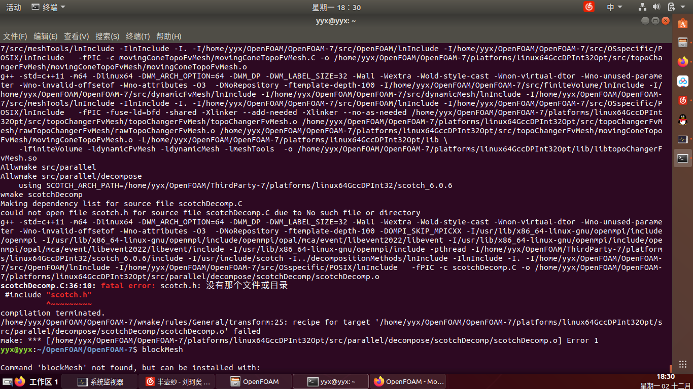

    按照东岳流体网站上的编译安装步骤,结果出现以下问题,请问各位前辈要如何解决呢,谢谢,
    scotchDecomp.C:36:10: fatal error: scotch.h: 没有那个文件或目录
     #include "scotch.h"
    compilation terminated.
    /home/yyx/OpenFOAM/OpenFOAM-7/wmake/rules/General/transform:25: recipe for target '/home/yyx/OpenFOAM/OpenFOAM-7/platforms/linux64GccDPInt32Opt/src/parallel/decompose/scotchDecomp/scotchDecomp.o' failed
    make: *** [/home/yyx/OpenFOAM/OpenFOAM-7/platforms/linux64GccDPInt32Opt/src/parallel/decompose/scotchDecomp/scotchDecomp.o] Error 1

    openform版本为7,系统为ubuntn18,希望能有知道的前辈指导一下,万分感谢
    确保你下载ThirdParty-7.0并且在正确的位置。scotch在ThirdParty-7.0里面

    @东岳 非常感谢前辈,已经解决。
