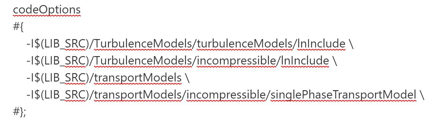

    functions
        test
            functionObjectLibs ( "libutilityFunctionObjects.so" );
            enabled         true;
            type            coded;
            redirectType    printMinU;
            writeControl    timeStep;
            writeInterval   1;
            codeInclude
                #include "turbulentTransportModel.H"
            codeOptions
                -I$(LIB_SRC)/TurbulenceModels/turbulenceModels/lnInclude \
                -I$(LIB_SRC)/TurbulenceModels/incompressible/lnInclude \
                -I$(LIB_SRC)/transportModels \
                -I$(LIB_SRC)/transportModels/incompressible/singlePhaseTransportModel \
            codeExecute
                label patchID = mesh().boundaryMesh().findPatchID("fixedWalls");
                const Foam::incompressible::turbulenceModel& turbModel =
                    mesh().thisDb().lookupObject<Foam::incompressible::turbulenceModel>("turbulenceProperties");
                const scalarField& y = turbModel.y()[patchID];
                Info << "y= " << y << endl;
    https://www.cfd-online.com/Forums/openfoam-programming-development/158126-codeinclude-coded-function-controldict-yplus.html
    上述代码在OpenFOAM-7下可以运行,但结果好像y+是定值,你继续debug下看看哪里有问题
