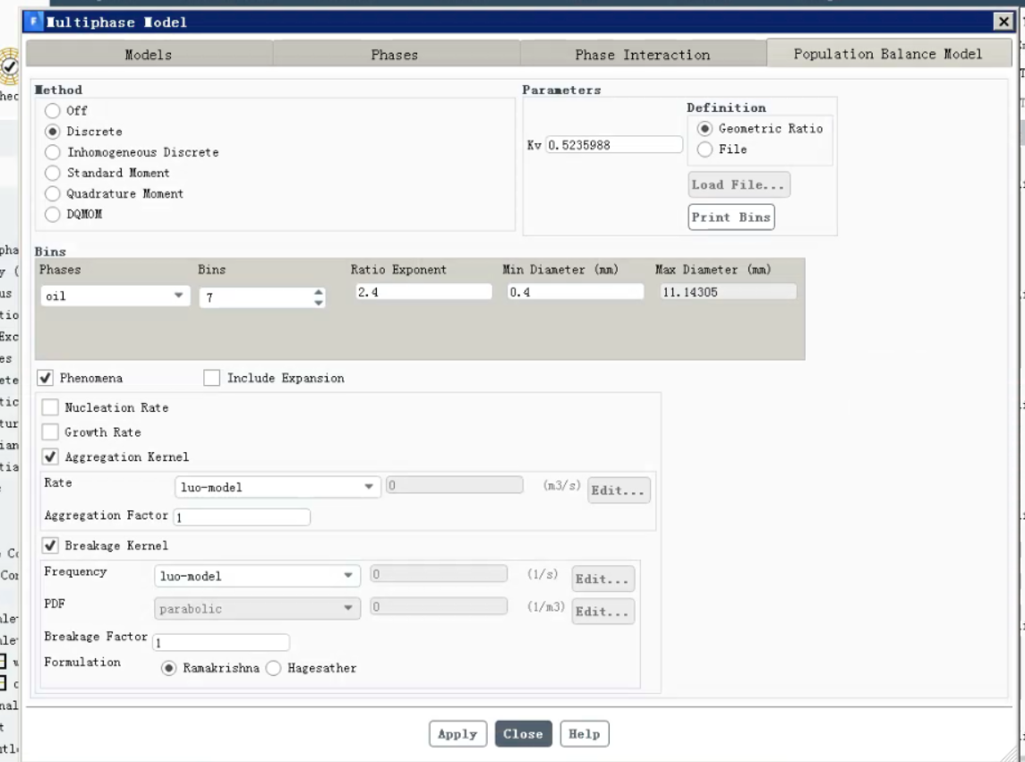

    连续相:水;分散相:硅油(αd=0.01v%)。油在水中分散。速度进口,压力出口。湍流模型选SST K-w。用PBM模拟液滴直径分布。

    PBM设置如下:离散法求解,7个bins,比例指数为2.4,给定的最小分散相粒径为0.4mm,破碎和聚并和均为luo模型。
    Bin Sizes for oil (7) :-
    Bin Number Bin Size (mm)
    Bin-0 11.143047
    Bin-1 6.4
    Bin-2 3.6758347
    Bin-3 2.1112127
    Bin-4 1.2125733
    Bin-5 0.69644045
    Bin-6 0.4
    计算过程中发散,提示如下:
    Error at Node 14:
    Divergence in Luo Breakup kernel.
    Please stop iterating and check solution - parent dia = 1.114305e-02, daughter dia = 3.258247e-03!!
    有路过的大佬帮忙看看不?卡了好久,不知怎么解决?提前谢谢了~
