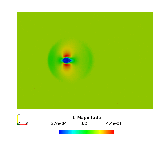

    请教各位,关于浸入边界法(IBM)(直接力法)的问题
    我最近在用rhocentralFoam求解器做圆柱绕流,结果后处理速度云图时,会出现如图所示的波动,我采用的是下面的边界条件,想问一下是什么原因?如果我进一步缩小时间步长或者调整网格大小会有帮助嘛?
    0/U
    internalField   uniform (0.3 0 0);
    boundaryField
        inlet
            type            fixedValue;
            value           uniform (0.3 0 0);
        outlet
            type            zeroGradient;
        bottom
            type            zeroGradient;
        top
            type            zeroGradient;
        defaultFaces
            type            empty;
    你是调整物性把音速改了么?

    @李东岳 是的,李老师。音速是1m/s。
    下面是我的thermophysicalProperties
    thermoType
        type            hePsiThermo;
        mixture         pureMixture;
        transport       const;
        thermo          hConst;
        equationOfState perfectGas;
        specie          specie;
        energy          sensibleInternalEnergy;
    // Note: these are the properties for a "normalised" inviscid gas
    //       for which the speed of sound is 1 m/s at a temperature of 1K
    //       and gamma = 7/5
    mixture
        specie
            nMoles          1;
            molWeight       11640.3;
        thermodynamics
            Cp              2.5;
            Hf              0;
        transport
            mu              0.00933;
            Pr              1;
