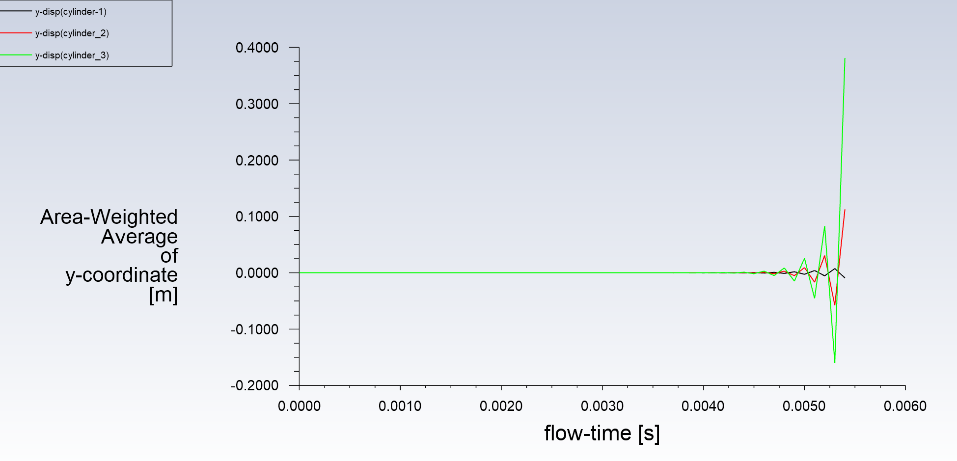

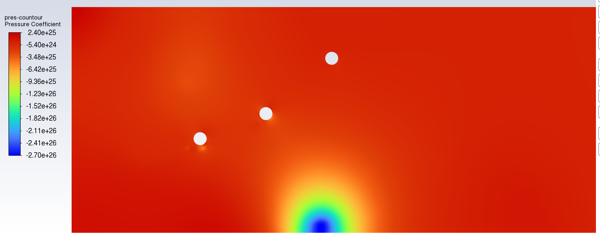

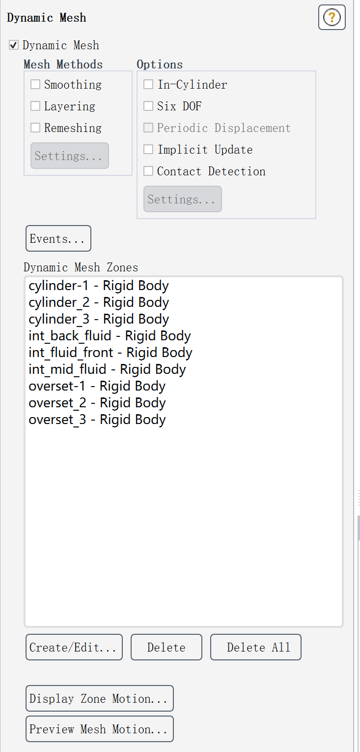

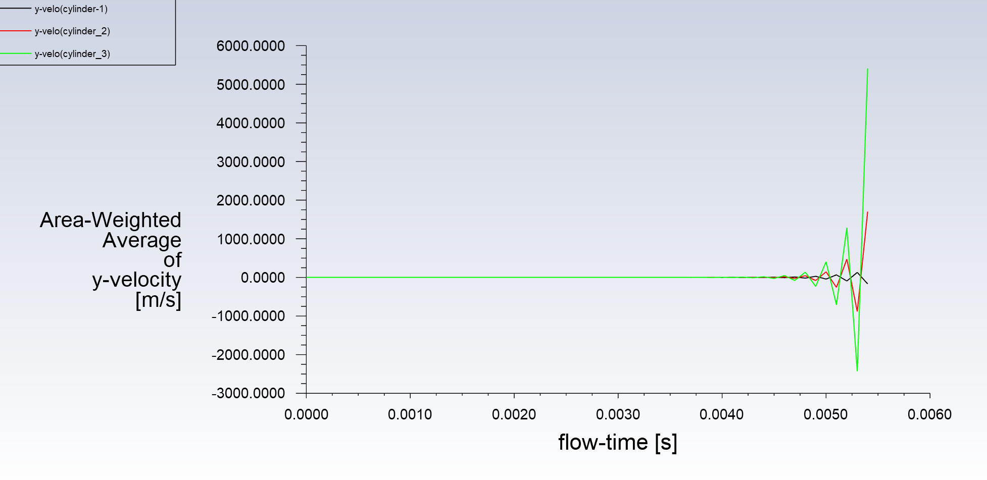

    采用overset重叠网格和UDF函数模拟串列三圆柱的涡激振动,其中UDF分别尝试了Newmark-Beta方法和4阶Runge Kutta法获取圆柱的振动响应,通过DEFINE_CG_MOTION宏赋予三个圆柱及component cells的运动速度,算例的雷诺数约200,采用k-omega sst模型,考虑水作为来流介质,计算过程中尝试了时间步长从1.0e-3缩小到1.0e-5等多个量级,但是求解过程总是出现升力和升力矩突然骤增,继而导致圆柱运动速度过大,最终计算发散。
    请各位大佬帮忙看看是哪里出问题?
    具体的UDF和部分设置如下:

    		real Keff = k + term0;
    		real Reff = fy*water_depth + term0*cg[1] + term1*vy3 + term2*ay3;
    		Message("Velocity: %f \n",vy3);
    		dy3 = Reff/Keff - cg[1];
    		y3 += dy3;
    		real vprev = vy3;
    		vy3 = (gamma/(beta*dtime))*dy3 + (1-(gamma/beta))*vy3 + dtime*(1-(gamma/(2*beta)))*ay3;
    		ay3 = (1/(beta*dtime*dtime))*dy3 - (1/(beta*dtime))*vprev - ((1/(2*beta))-1)*ay3;
    		/*Runge-kutta 4th order*/
    		real K1 = (fy*water_depth - c*vy3RK - k*y3RK) / total_mass;
    		real K2 = (fy*water_depth - c*(vy3RK+dtime*0.5*K1) - k*(y3RK+dtime*0.5*vy3RK)) / total_mass;
    		real K3 = (fy*water_depth - c*(vy3RK+dtime*0.5*K2) - k*(y3RK+dtime*0.5*vy3RK+dtime*dtime*K1/4)) / total_mass;
    		real K4 = (fy*water_depth - c*(vy3RK+dtime*K3) - k*(y3RK+dtime*vy3RK+dtime*dtime*K1/2)) / total_mass;
    		y3RK = y3RK + vy3RK*dtime + dtime*dtime*(K1 + K2 + K3 + K4)/6;
    		vy3RK = vy3RK + dtime*(K1 + K2 + K3 + K4)/6;
    		/*Transfer result to the dynamic mesh*/
    		vel[0] = 0.0;
    		vel[1] = vy3RK;
    		/*Save files*/
    		#if !RP_NODE
    			/*Message ("Force = %f, pos = %f, vel = %f, acc = %f\n", fy, cg[1], y, vy);*/
    			if(NULL == (outNB = fopen("dataNB3.txt","a")))
    				Error("Could not open file for append!\n");
    			fprintf(outNB,"%16.4e %12.1f %16.3e %16.7f %16.7f %16.7f \n", ctime,niter, fy , cg[1], y3, vy3);
    			fclose(outNB);
    			if(NULL == (outRK = fopen("dataRK3.txt","a")))
    			fprintf(outRK,"%16.4e %12.1f %16.3e %16.7f %16.7f %16.7f \n", ctime,niter, fy , cg[1], y3RK, vy3RK);
    			fclose(outRK);
    		#endif
    	vel[0] = 0.0;
    	vel[1] = vy3RK;
    DEFINE_CG_MOTION(cylinder_3_frontgrid_1,dt,vel,omega,time,dtime)
    		NV_S(vel, =, 0.0);
    		NV_S(omega, =, 0.0);
    		vel[0]=0.0;
    		vel[1]=vy3RK;
    DEFINE_CG_MOTION(cylinder_3_overset_2,dt,vel,omega,time,dtime)
    		NV_S(vel, =, 0.0);
    		vel[0]=0.0;
    		vel[1]=vy3RK;
    DEFINE_ZONE_MOTION(cylinder_3_zone,omega,axis,origin,velocity,time,dtime)
    	N3V_D(velocity, =, 0, 0, 0);
    	N3V_S(origin, =, 0.32);
    	N3V_D(axis, =, 0.0, 0.0, 1.0);
    	velocity[1]=vy3RK;
    运动速度
    运动位移
    压力系数
    动网格设置
