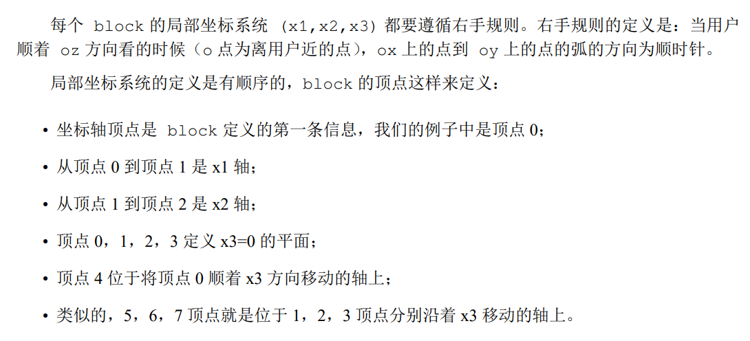

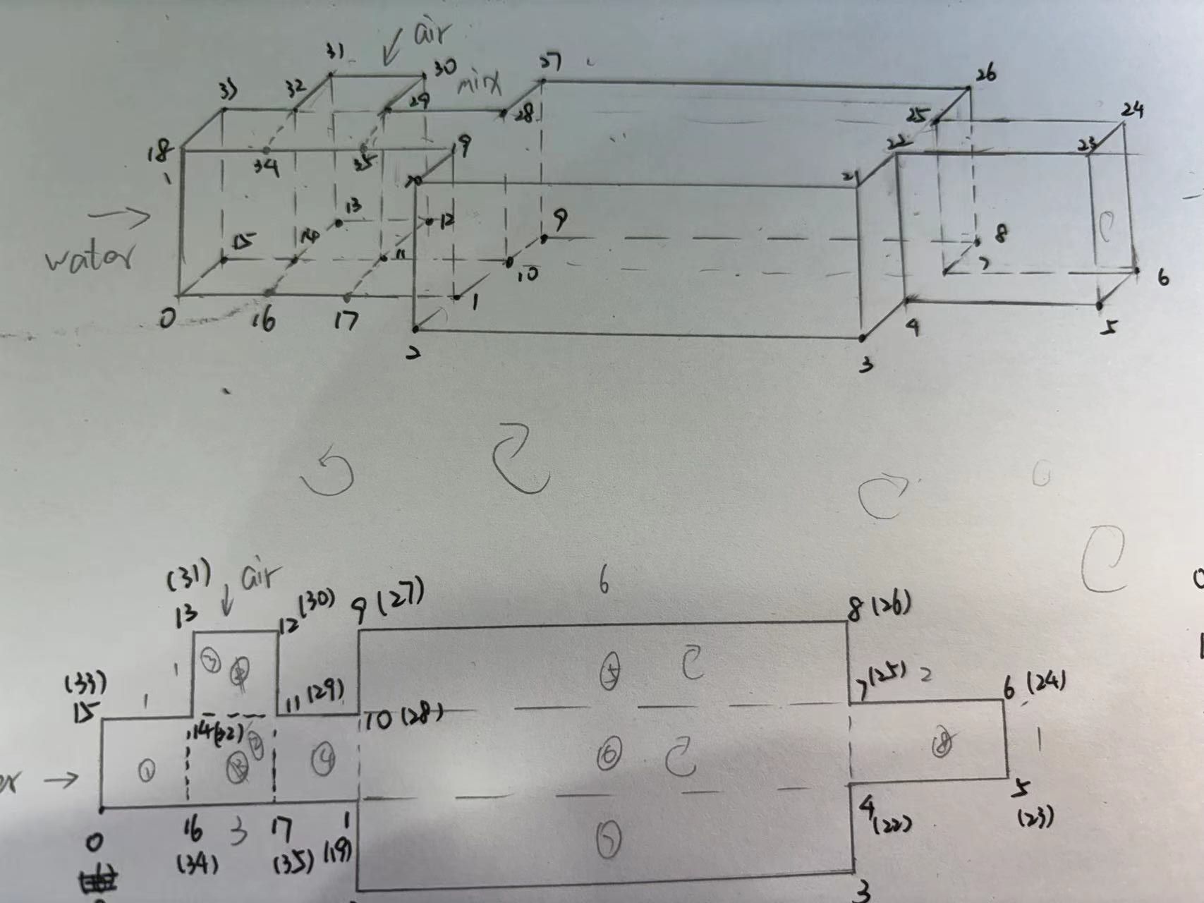

    blockmesh生成网格总报错没有相邻面,改来改去总有这个问题,还是不同的面报错,这是为什么呢?哭QvQ
    --> FOAM FATAL ERROR:
    face 0 in patch 0 does not have neighbour cell face: 4(12 13 31 30)
        From function Foam::labelList Foam::polyMesh::facePatchFaceCells(const faceList&, const labelListList&, const faceListList&, Foam::label) const
        in file meshes/polyMesh/polyMeshFromShapeMesh.C at line 118.
    ![e1752f4f83bfed1f6e8b47f61921b5a.jpg](/assets/uploads/files/1700296198954-e1752f4f83bfed1f6e8b47f61921b5a.jpg)
    blockmeshdict
    convertToMeters 1;
    vertices
        (0 1 0)
        (3 1 0)
        (3 0 0)
        (9 0 0)
        (9 1 0)
        (11 1 0)
        (11 2 0)
        (9 2 0)
        (9 3 0)
        (3 3 0)
        (3 2 0)
        (2 2 0)
        (2 3 0)
        (1 3 0)
        (1 2 0)
        (0 2 0)
        (1 1 0)
        (2 1 0)
        (0 1 0.1)
        (3 1 0.1)
        (3 0 0.1)
        (9 0 0.1)
        (9 1 0.1)
        (11 1 0.1)
        (11 2 0.1)
        (9 2 0.1)
        (9 3 0.1)
        (3 3 0.1)
        (3 2 0.1)
        (2 2 0.1)
        (2 3 0.1)
        (1 3 0.1)
        (1 2 0.1)
        (0 2 0.1)
        (1 1 0.1)
        (2 1 0.1)
    blocks
        hex (0 16 14 15 18 34 32 33)   (10 10 1) simpleGrading (1 1 1) //1
        hex (16 17 11 14 34 35 29 32)  (10 10 1) simpleGrading (1 1 1) //2
        hex (14 11 12 13 29 30 31 32)  (10 10 1) simpleGrading (1 1 1) //3
        hex (17 11 29 35 1 10 28 19)   (10 10 1) simpleGrading (1 1 1) //4
        hex (10 9 27 28 7 8 26 25)     (60 10 1) simpleGrading (1 1 1) //5
        hex (1 4 7 10 19 22 25 28)     (60 10 1) simpleGrading (1 1 1) //6
        hex (2 1 19 20 3 4 22 21)      (60 10 1) simpleGrading (1 1 1) //7
        hex (4 7 25 22 5 6 24 23)      (20 10 1) simpleGrading (1 1 1) //8
    boundary
        inletair
            type patch;
            faces
                (12 13 31 30)
        inletwater
            type patch;
            faces
                (0 18 33 15)
        outlet
            type patch;
            faces
                (5 6 24 23)
        wall
            type wall;
            faces
                (0 16 34 18) //FRONT
                (16 17 35 34)
                (35 17 1 19)
                (20 19 1 2)
                (20 2 3 21)
                (3 4 22 21)
                (4 5 23 22)
                (33 18 34 32) //UP
                (32 34 35 29)
                (35 19 28 29)
                (31 32 29 30)
                (26 27 28 25)
                (25 28 19 22)
                (22 19 20 21)
                (23 24 25 22)
                (14 15 33 32) //BACK
                (32 31 13 14)
                (12 30 29 11)
                (29 28 10 11)
                (10 28 27 9)
                (9 27 26 8)
                (7 8 26 25)
                (6 7 25 24)
                (0 15 14 16) //DOWN
                (16 14 11 17)
                (14 13 12 11)
                (1 17 11 10)
                (10 9 8 7)
                (1 10 7 4)
                (2 1 4 3)
                (5 4 7 6)

    @chapaofan 在 blockmesh生成网格总报错没有相邻面 中说:
    上面的顺序错了。
    可能是下面这个:
    hex (14 11 12 13 32 29 30 31) (10 10 1) simpleGrading (1 1 1) //3
    chapaofan
    在 中回复了 xiezhuoyu 最后由 编辑
    @xiezhuoyu 修改过后这样报错是为什么呢?我之前修改也会这样报错
    Inconsistent number of faces between block pair 1 and 3
    xiezhuoyuX 1 条回复 最后回复
  • xiezhuoyuX 离线
    xiezhuoyuX 离线
    xiezhuoyu
    在 中回复了 chapaofan 最后由 编辑
    @chapaofan
    这里面有矛盾的设置。
    每条边上的单元数改为10试试(下图),再慢慢调整。
    chapaofan
    @xiezhuoyu oh!非常感谢!我再慢慢调整一下
    chapaofan
    找到问题所在了。大家一定要从离原点最近的坐标开始定义block,要不然划分网格就会乱掉QvQ

    @liurui 面的编号要用右手定则指向计算域外侧,所以就比如第一个hex应该是(0 7 6 1 8 9 14 15)
