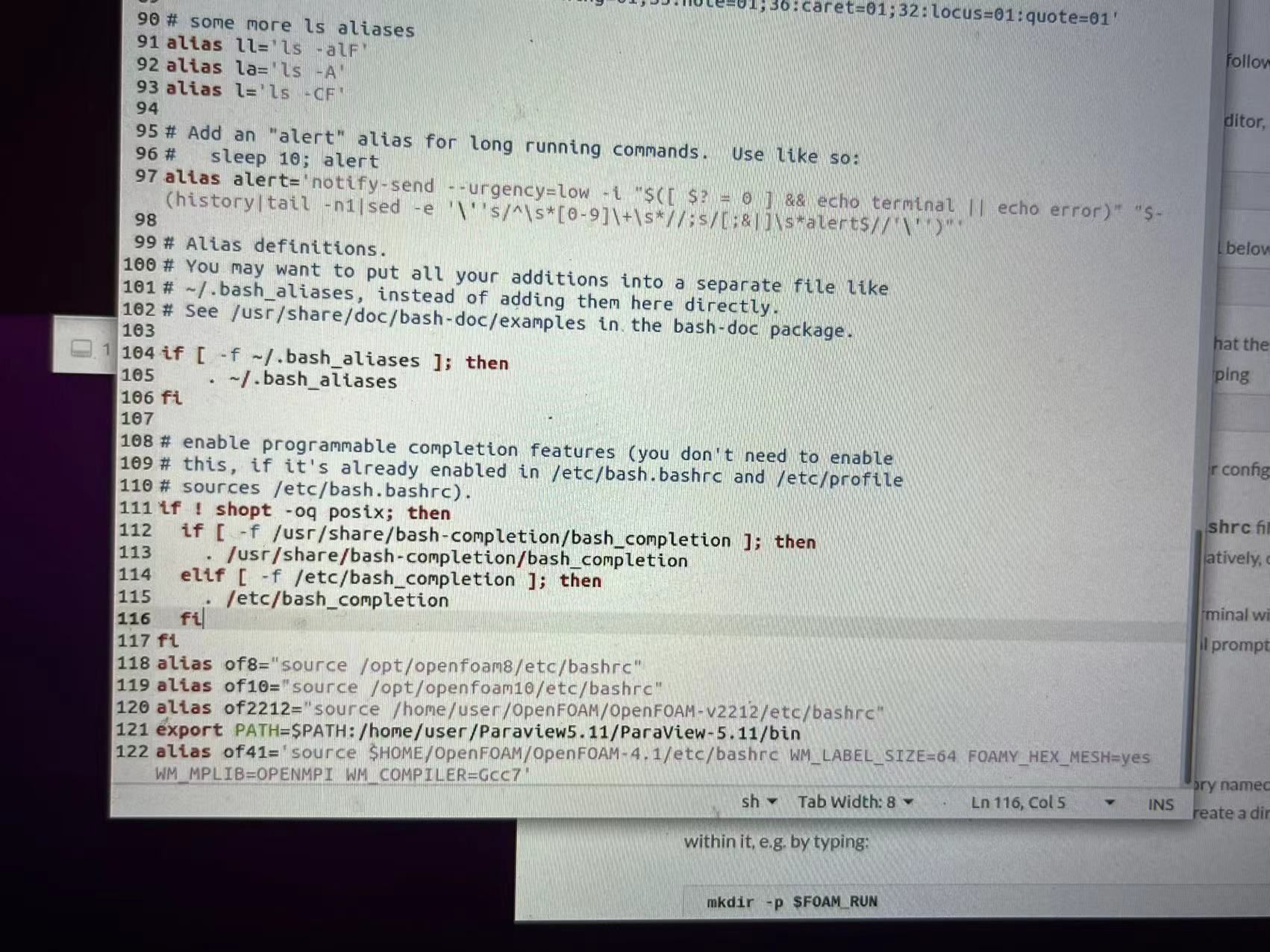

    服务器上安装了多个版本的OpenFOAM。当服务器重启后,运行of41版本下的求解器没有问题,但当运行其他版本(如of2212)下的求解器后,再回来运行of41版本下的求解器就会出现如下的问题:vaporTemphasecompressibleInterFoam: symbol lookup error: /home/user/OpenFOAM/ThirdParty-4.1/platforms/linux64Gcc7/openmpi-1.10.2/lib64/libmca_common_verbs.so.7: undefined symbol: ompi_common_verbs_usnic_register_fake_drivers。想请问大家怎么解决呢?非常感谢!
    你们两个版本是怎么切换的

    ,您好,李老师,我在~/.bashrc里,多版本这样弄的切换方式.jpg
    of41写多了,参考of10,把没用的删掉

    删掉之后,同样无法运行求解,报错如下:
    mpirun was unable to find the specified executable file, and therefore did not launch the job. This error was first reported for process rank 0; it may have occurred for other processes as well.
    NOTE: A common cause for this error is misspelling a mpirun command line parameter option (remember that mpirun interprets the first unrecognized command line token as the executable).
    Node: user-MZ32-AR0-00
    Executable: vaporemphasecompressibleInterFoam

    似乎解决了这个问题,把文本中的单引号改为双引号后,现在切换版本运行目前没啥问题:135:
