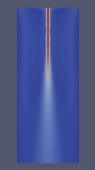

    各位大佬,请问谁有经验处理过类似jet的boundary condition?
    下图是使用incompressible solver后达到steady-state的速度场,现在因为其他原因,要使用comprenssible solver,但是使用相同的边界条件会导致计算发散。
    目前的compressible solver 的边界条件如下

    速度不是很高,但是gradient很大,速度的峰值在12m/s 左右,gradient在整个diameter 10% 左右就变为0了。
    网格也不是很复杂,是一个圆柱,中间有加密的ogrid

    老问题,我也遇到过几次,我是压力速度耦合部分发散,试过如下修改,压力出口用无反射边界条件(可压缩),使用湍流模型时时间步长减小,直接喷管出口的速度入口可以试一下1/7次方速度分布而不是均匀速度进入

    麻烦介绍一下哪个是无反射边界条件?
    速度入口我没法修改的,是实验数据
    回来了,都回来了~
    yfclark 神
    waveTransmissive,我说的速度是考虑出口边界层对速度在空间上分布的影响,如果实验测的分布很真实,不需要考虑这个

    GAMG:  Solving for p, Initial residual = 7.7608e-08, Final residual = 5.611e-08, No Iterations 1
    diagonal:  Solving for rho, Initial residual = 0, Final residual = 0, No Iterations 0
    time step continuity errors : sum local = 5.9e-11, global = -4.0674e-11, cumulative = -9.1989e-09
    rho max/min : 1.878 0.98689
    GAMG:  Solving for epsilon, Initial residual = 1, Final residual = 4.5124e-08, No Iterations 9
    bounding epsilon, min: -2.6567e+14 max: 9.8944e+14 average: 4.3069e+11
    GAMG:  Solving for k, Initial residual = 3.1203e-05, Final residual = 3.4191e-08, No Iterations 3
    bounding k, min: -0.0028429 max: 1.1084e+08 average: 13164
    PIMPLE: iteration 4
    GAMG:  Solving for Ux, Initial residual = 0.69715, Final residual = 8.8458e-13, No Iterations 1
    GAMG:  Solving for Uy, Initial residual = 0.66265, Final residual = 5.0469e-13, No Iterations 1
    GAMG:  Solving for Uz, Initial residual = 0.89007, Final residual = 1.8401e-13, No Iterations 1
    DILUPBiCG:  Solving for H2O:  solution singularity
    DILUPBiCG:  Solving for h, Initial residual = 0.93521, Final residual = 0.060826, No Iterations 1
    T gas min/max   = -28.694, 299.97
    GAMG:  Solving for p, Initial residual = 0.17195, Final residual = 7.8752e-08, No Iterations 29
    GAMG:  Solving for p, Initial residual = 8.8696e-08, Final residual = 6.5726e-08, No Iterations 1
    time step continuity errors : sum local = 7.5836e-11, global = 5.0269e-11, cumulative = -9.1486e-09
    rho max/min : 1.4518 0
    GAMG:  Solving for p, Initial residual = 0.05066, Final residual = 9.9767e-08, No Iterations 26
    GAMG:  Solving for p, Initial residual = 1.027e-07, Final residual = 7.4687e-08, No Iterations 1
    time step continuity errors : sum local = 8.1351e-11, global = -5.5958e-11, cumulative = -9.2046e-09
    rho max/min : 1.3965 0
    GAMG:  Solving for p, Initial residual = 0.016961, Final residual = 8.0106e-08, No Iterations 23
    GAMG:  Solving for p, Initial residual = 8.0702e-08, Final residual = 5.627e-08, No Iterations 1
    time step continuity errors : sum local = 6.0392e-11, global = 4.4356e-11, cumulative = -9.1602e-09
    rho max/min : 1.3959 0
    GAMG:  Solving for epsilon, Initial residual = 1, Final residual = 6.2629e-16, No Iterations 1
    bounding epsilon, min: -2.2666e+12 max: 4.6152e+10 average: -2.4192e+07
    GAMG:  Solving for k, Initial residual = 0.99984, Final residual = 1.5475e-11, No Iterations 1
    bounding k, min: -2.7051e+07 max: 5.1083e+07 average: 6384.9
    PIMPLE: iteration 5
    GAMG:  Solving for Ux, Initial residual = 0.88859, Final residual = 1.3661e-07, No Iterations 1000
    GAMG:  Solving for Uy, Initial residual = 0.9647, Final residual = 9.9942e-08, No Iterations 598
    GAMG:  Solving for Uz, Initial residual = 0.90627, Final residual = 4.0161e-06, No Iterations 1000
    DILUPBiCG:  Solving for h, Initial residual = 1, Final residual = 0.024346, No Iterations 2
    [7]
    [7]
    [7] --> FOAM FATAL ERROR:
    [7] Maximum number of iterations exceeded
    [7]
    [7]     From function Foam::scalar Foam::species::thermo<Thermo, Type>::T(Foam::scalar, Foam::scalar, Foam::scalar, Foam::scalar (Foam::species::thermo<Thermo, Type>::*)(Foam::scalar, Foam::scalar)const, Foam::scalar (Foam::species::thermo<Thermo, Type>::*)(Foam::scalar, Foam::scalar)const, Foam::scalar (Foam::species::thermo<Thermo, Type>::*)(Foam::scalar)const) const [with Thermo = Foam::hConstThermo<Foam::perfectGas<Foam::specie> >; Type = Foam::sensibleEnthalpy; Foam::scalar = double; Foam::species::thermo<Thermo, Type> = Foam::species::thermo<Foam::hConstThermo<Foam::perfectGas<Foam::specie> >, Foam::sensibleEnthalpy>]
    [7]     in file /export/opt/openfoam/OpenFOAM-4.1/src/thermophysicalModels/specie/lnInclude/thermoI.H at line 66.
    [7]
    FOAM parallel run aborting
    [7]
    [7] #0  Foam::error::printStack(Foam::Ostream&) at ??:?
    [7] #1  Foam::error::abort() at ??:?
    [7] #2  Foam::species::thermo<Foam::hConstThermo<Foam::perfectGas<Foam::specie> >, Foam::sensibleEnthalpy>::THs(double, double, double) const at ??:?
    [7] #3  Foam::hePsiThermo<Foam::psiReactionThermo, Foam::SpecieMixture<Foam::reactingMixture<Foam::constTransport<Foam::species::thermo<Foam::hConstThermo<Foam::perfectGas<Foam::specie> >, Foam::sensibleEnthalpy> > > > >::calculate() at ??:?
    [7] #4  Foam::hePsiThermo<Foam::psiReactionThermo, Foam::SpecieMixture<Foam::reactingMixture<Foam::constTransport<Foam::species::thermo<Foam::hConstThermo<Foam::perfectGas<Foam::specie> >, Foam::sensibleEnthalpy> > > > >::correct() at ??:?
    [7] #5  ? at ??:?
    [7] #6  __libc_start_main in "/lib/x86_64-linux-gnu/libc.so.6"
    [7] #7  ?--------------------------------------------------------------------------
    MPI_ABORT was invoked on rank 7 in communicator MPI_COMM_WORLD
    with errorcode 1.
    NOTE: invoking MPI_ABORT causes Open MPI to kill all MPI processes.
    You may or may not see output from other processes, depending on
    exactly when Open MPI kills them.
    at ??:?
    ^C

    好像是湍流先发散啊,然后是温度
    星 1 条回复 最后回复
  • 星 离线
    星 离线
    星星星星晴 大神
    在 中回复了 yfclark 最后由 编辑
    @yfclark 是的,而且我用的PIMPLE,一直连内循环都不收敛 很头大
