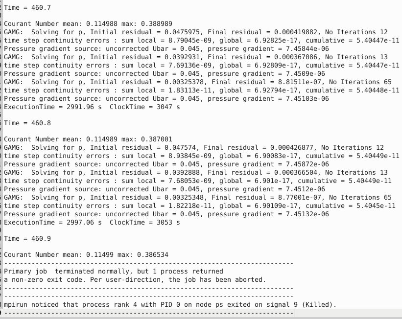

  • X 离线
    X 离线
    XIN
    @李东岳
    log文件最后是这样的
    Time = 460.8
    Courant Number mean: 0.114989 max: 0.387001
    GAMG: Solving for p, Initial residual = 0.047574, Final residual = 0.000426877, No Iterations 12
    time step continuity errors : sum local = 8.93845e-09, global = 6.90083e-17, cumulative = 5.40449e-11
    Pressure gradient source: uncorrected Ubar = 0.045, pressure gradient = 7.45872e-06
    GAMG: Solving for p, Initial residual = 0.0392888, Final residual = 0.000366504, No Iterations 13
    time step continuity errors : sum local = 7.68053e-09, global = 6.901e-17, cumulative = 5.40449e-11
    Pressure gradient source: uncorrected Ubar = 0.045, pressure gradient = 7.4512e-06
    GAMG: Solving for p, Initial residual = 0.00325348, Final residual = 8.77001e-07, No Iterations 65
    time step continuity errors : sum local = 1.82218e-11, global = 6.90109e-17, cumulative = 5.4045e-11
    Pressure gradient source: uncorrected Ubar = 0.045, pressure gradient = 7.45132e-06
    ExecutionTime = 2997.06 s ClockTime = 3053 s
    Time = 460.9
    Courant Number mean: 0.11499 max: 0.386534
    Primary job terminated normally, but 1 process returned
    a non-zero exit code. Per user-direction, the job has been aborted.
    mpirun noticed that process rank 4 with PID 0 on node ps exited on signal 9 (Killed).
    你这个错误的信息log没有输出出来
    这个不是错误信息
