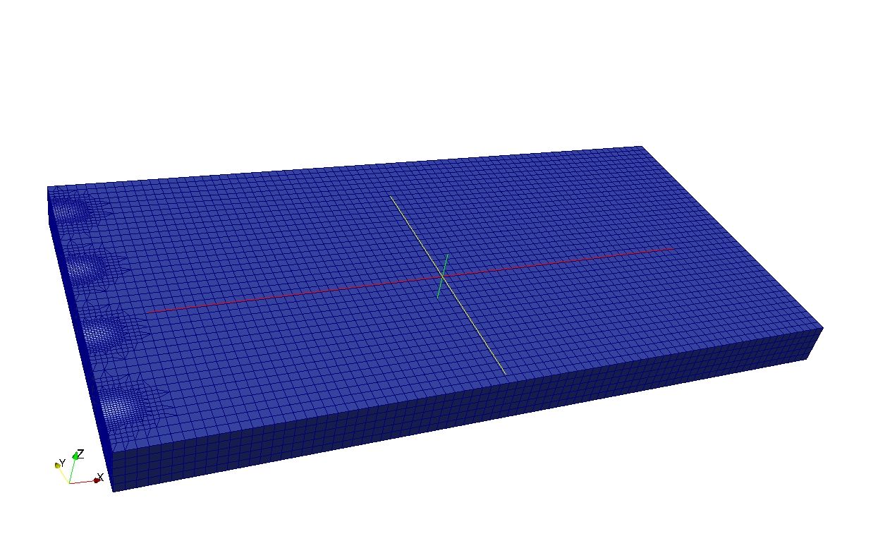

    各位前辈,我在自适应(AMR)求解器中,对左侧点火端开口,前后面设置为cyclic周期性边界条件,其他面为壁面的算例进行计算时,出现如下报错:
    [14]     Compared coord: (0.0159 0 0.0009) at index 402 with difference to point 0.008
    [14] processorPolyPatch::order : Writing faces to OBJ file procBoundary14to0throughbackwall_faces.obj
    [14] processorPolyPatch::order : Dumping newly found match as lines between corresponding face centres to OBJ file "/home/customer/Desktop/cyclicTest_zhu/3D-H2-initial-mpi-combustion/processor14/procBoundary14to0throughbackwall_faceCentresConnections.obj"
    [14] --> FOAM Serious Error :
    [14]     From function processorPolyPatch::order(const primitivePatch&, labelList&, labelList&) const
    [14]     in file meshes/polyMesh/polyPatches/constraint/processor/processorPolyPatch.C at line 1015
    [14]     in patch:procBoundary14to0throughbackwall : Cannot match vectors to faces on both sides of patch
    [14]     masterCtrs[0]:(0.0001 0 0.0001)
    [14]     ctrs[0]:(0.0001 0.008 0.0001)
    [14]     Check your topology changes or maybe you have multiple separated (from cyclics) processor patches
    [14]     Continuing with incorrect face ordering from now on
    Refined from 49761 to 50139 cells.
    Selected 21 split points out of a possible 4247.
    [0]
    [0]
    [0] --> FOAM FATAL ERROR:
    [0] Problem. Cannot find (13 452) or 877 (0.0001 0 0.0006) in 1((877 13))
    remoteTransformI:-1
    localTransformI:13
    [0]
    [0]     From function globalMeshData::findTransform(..)
    [0]     in file meshes/polyMesh/globalMeshData/globalMeshData.C at line 848.
    [0]
    FOAM parallel run aborting
    [0]
    [0] #0  Foam::error::printStack(Foam::Ostream&) at ??:?
    [0] #1  Foam::error::abort() at ??:?
    [0] #2  Foam::globalMeshData::findTransform(Foam::List<Foam::Pair<int> > const&, Foam::Pair<int> const&, int) const at ??:?
    [0] #3  Foam::globalMeshData::calcGlobalEdgeSlaves() const at ??:?
    [0] #4  Foam::globalMeshData::globalEdgeSlavesMap() const at ??:?
    [0] #5  void Foam::syncTools::syncEdgeList<int, Foam::maxEqOp<int>, Foam::mapDistribute::transform>(Foam::polyMesh const&, Foam::List<int>&, Foam::maxEqOp<int> const&, int const&, Foam::mapDistribute::transform const&) at ??:?
    [0] #6  Foam::removeFaces::setRefinement(Foam::List<int> const&, Foam::List<int> const&, Foam::List<int> const&, Foam::polyTopoChange&) const at ??:?
    [0] #7  Foam::hexRef8::setUnrefinement(Foam::List<int> const&, Foam::polyTopoChange&) at ??:?
    [0] #8  Foam::dynamicRefineFvMesh::unrefine(Foam::List<int> const&) at ??:?
    [0] #9  Foam::dynamicRefineFvMesh::update() at ??:?
    [0] #10  ? at ??:?
    [0] #11  __libc_start_main in "/lib64/libc.so.6"
    [0] #12  ? at ??:?

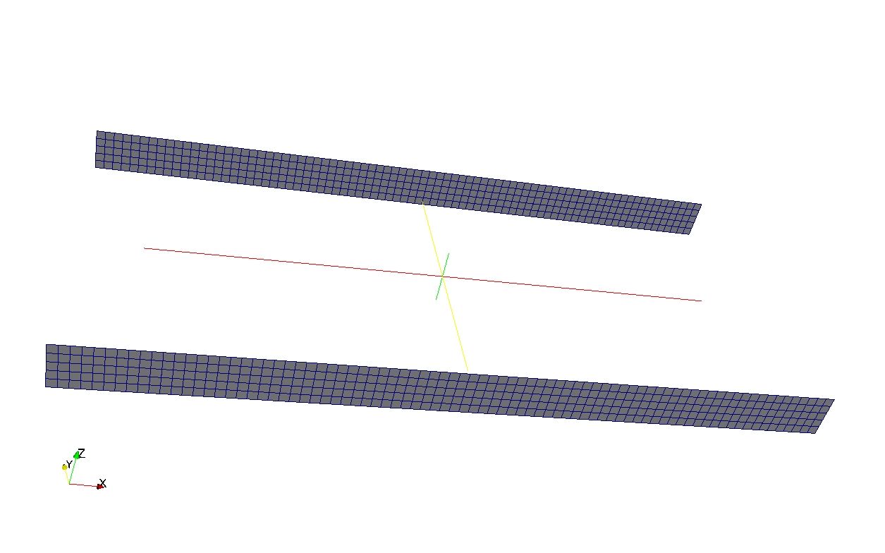

    模型如下
    周期性边界:
    我的Boundary文件是这样的:
    boundary
         outlet
            type patch;
            faces
               (0 4 7 3)
         endwall
            type patch;
            faces
               (1 2 6 5)
         upperwall
            type wall;
            faces
               (4 5 6 7)
         lowerwall
            type wall;
            faces
               (0 3 2 1)
         frontwall
            type cyclic;
            faces
               (0 1 5 4)
            neighbourPatch backwall;
         backwall
            type cyclic;
            faces
               (6 2 3 7)
         neighbourPatch frontwall;
    mergePatchPairs
    我目前怀疑是因为网格不断加密后,由于数据的传输出现问题导致,有没有遇到过类似问题可以一起讨论一下的。
    luca
    单核是可以运行的,但是一旦并行运算就会报错。
