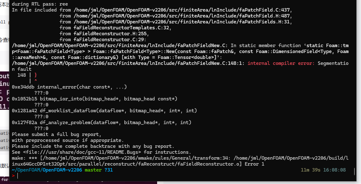

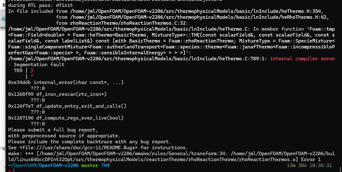

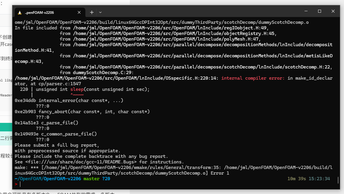

    请教下各位老师,我有两台配置一样的电脑,一台正常,另一台通过东岳流体上的命令安装ofv2206,会出现如下报错,每次编译的出错的位置不一样,但问题都是相同的。我检查了两台电脑的WSL2 Ubuntu gcc版本,都是一致的。有谁遇到过相同的问题吗,求解答,谢谢!
    ab9e6d98-ad3a-411e-b491-d896f46efe94-f6cfa23dd5c7b85d2221cf4ad1bcdbb.png 6233d72d-ff4f-43d3-a833-712fd509220d-微信截图_20250702103715.png
    什么版本的gcc

    @李东岳 11.4.0 岳子哥
    可能两台WSL安装时间不一样。你用9试试

    @李东岳 没改g++的版本 我现在改成g++ 9 再试试

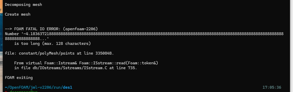

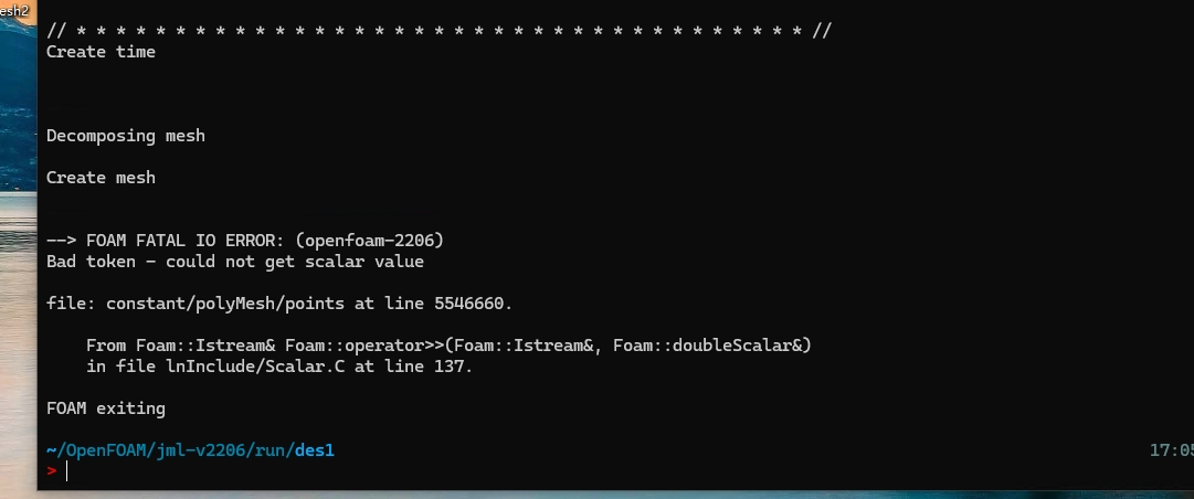

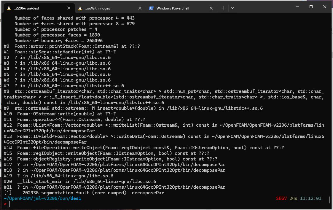

    @李东岳 每次的报错还不一样,网格是从能用的那台电脑复制过来的,都是WSL2
    79263b10-a4f6-42a1-8b39-59ae08c8465e-微信截图_20250702170609.png f626ea14-57b2-4d37-854d-40a3daf5db07-微信截图_20250702170616.png
    你测试不复制网格。直接纯WSL生成网格等一系列操作,正常么

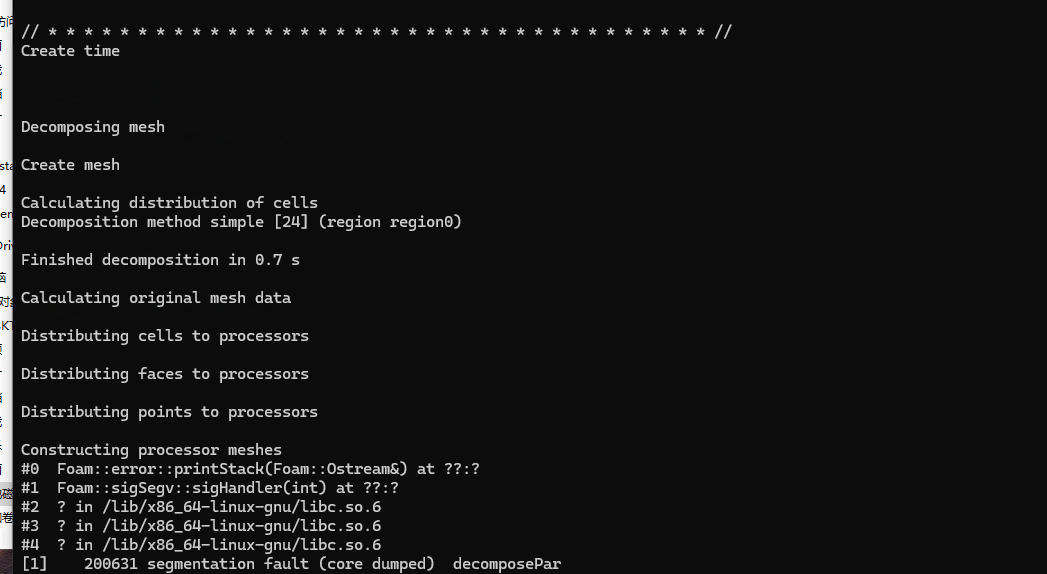

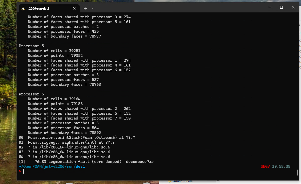

    Afr1yne
    @李东岳 tutorials里面的都能跑

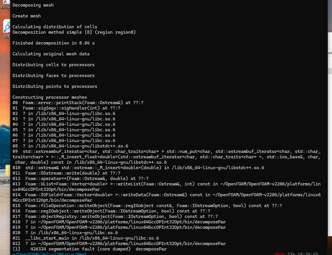

    这也是报错之一,每次不一样
    decomposePar
    | \ / F ield | OpenFOAM: The Open Source CFD Toolbox |
    | \ / O peration | Version: 2206 |
    | \ / A nd | Website: www.openfoam.com |
    | \/ M anipulation | |
    Build : b5c77f48-20220715 OPENFOAM=2206 version=v2206
    Arch : "LSB;label=32;scalar=64"
    Exec : decomposePar
    Date : Jul 02 2025
    Time : 17:22:38
    Host : DESKTOP-IJ7F4ME
    PID : 422821
    I/O : uncollated
    Case : /home/jml/OpenFOAM/jml-v2206/run/des1
    nProcs : 1
    trapFpe: Floating point exception trapping enabled (FOAM_SIGFPE).
    fileModificationChecking : Monitoring run-time modified files using timeStampMaster (fileModificationSkew 5, maxFileModificationPolls 20)
    allowSystemOperations : Allowing user-supplied system call operations
    Create time
    Decomposing mesh
    Create mesh
    Calculating distribution of cells
    Decomposition method scotch [24] (region region0)
    Finished decomposition in 1.23 s
    Calculating original mesh data
    Distributing cells to processors
    Distributing faces to processors
    Distributing points to processors
    Constructing processor meshes
    #0 Foam::error::printStack(Foam::Ostream&) at ??:?
    #1 Foam::sigSegv::sigHandler(int) at ??:?
    #2 ? in /lib/x86_64-linux-gnu/libc.so.6
    #3 ? in /lib/x86_64-linux-gnu/libc.so.6
    #4 ? in /lib/x86_64-linux-gnu/libc.so.6
    #5 ? in /lib/x86_64-linux-gnu/libc.so.6
    #6 ? in /lib/x86_64-linux-gnu/libc.so.6
    #7 ? in /lib/x86_64-linux-gnu/libc.so.6
    #8 ? in /lib/x86_64-linux-gnu/libstdc++.so.6
    #9 std::ostreambuf_iterator<char, std::char_traits<char> > std::num_put<char, std::ostreambuf_iterator<char, std::char_traits<char> > >::_M_insert_float<double>(std::ostreambuf_iterator<char, std::char_traits<char> >, std::ios_base&, char, char, double) const in /lib/x86_64-linux-gnu/libstdc++.so.6
    #10 std::ostream& std::ostream::_M_insert<double>(double) in /lib/x86_64-linux-gnu/libstdc++.so.6
    #11 Foam::OSstream::write(double) at ??:?
    #12 Foam::operator<<(Foam::Ostream&, double) at ??:?
    #13 Foam::UList<Foam::Vector<double> >::writeList(Foam::Ostream&, int) const in ~/OpenFOAM/OpenFOAM-v2206/platforms/linux64GccDPInt32Opt/bin/decomposePar
    #14 Foam::IOField<Foam::Vector<double> >::writeData(Foam::Ostream&) const in ~/OpenFOAM/OpenFOAM-v2206/platforms/linux64GccDPInt32Opt/bin/decomposePar
    #15 Foam::fileOperation::writeObject(Foam::regIOobject const&, Foam::IOstreamOption, bool) const at ??:?
    #16 Foam::regIOobject::writeObject(Foam::IOstreamOption, bool) const at ??:?
    #17 Foam::objectRegistry::writeObject(Foam::IOstreamOption, bool) const at ??:?
    #18 ? in ~/OpenFOAM/OpenFOAM-v2206/platforms/linux64GccDPInt32Opt/bin/decomposePar
    #19 ? in ~/OpenFOAM/OpenFOAM-v2206/platforms/linux64GccDPInt32Opt/bin/decomposePar
    #20 ? in /lib/x86_64-linux-gnu/libc.so.6
    #21 __libc_start_main in /lib/x86_64-linux-gnu/libc.so.6
    #22 ? in ~/OpenFOAM/OpenFOAM-v2206/platforms/linux64GccDPInt32Opt/bin/decomposePar
    [1] 422821 segmentation fault (core dumped) decomposePar
    不decomposePar能跑么

    @李东岳 单核不带温度内部场的codestream能跑
    所以能不能缩小到是decomposePar的问题?
