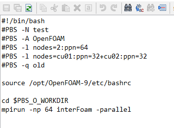

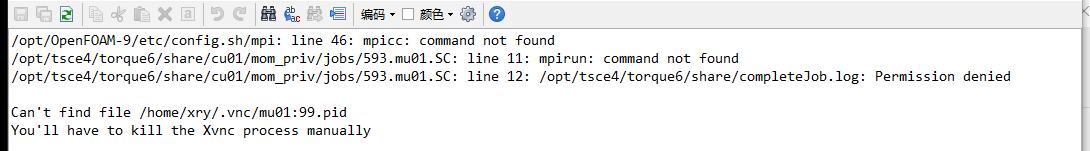

    系统是centos,是运维帮忙安装的of9,自己用xshell登录进去运行算例没有问题,上传pbs脚本运行就会出现mpicc :command not found

    试试把 MPI 的路径写到系统的 PATH 和 LD_LIBRARY_PATH 里面去。
    另外说个题外话,你的 pbs脚本里面最后一句有点问题,你需要指定 hostfile,要不然不管你用多少核,都只会在头节点上运行。比如上面,你制定了两个节点 cu01 和 cu02,每个32核共64核,但是如果按照你上面这个脚本提交作业,那么实际上是会在 cu01上面启动64个进程,cu02则空闲。

    @shrine 是不是装了别的版本的openfoam?xshell登录进去运行算例是怎么运行的?

    @cccrrryyy 我自己装了of8,运行不成功,出现glibc库版本不够。
    运维装的of9,xshell登录进去,多线程并行运行没有问题
    提交脚本就显示mpicc找不到,现在运维那边说就是glibc的原因

    @shrine
    可以在作业提交脚本里面加一些 echo 语句
    echo "PATH=$PATH"
    echo "LD_LIBRARY_PATH=$LD_LIBRARY_PATH"
    ldd $(which interFoam)
    同时,在你的 xshell里面,登录到服务器也执行这三个命令,对比一下输出有何区别,这样有助于定位问题。

    @xpqiu
    PATH=/usr/lib64/openmpi/bin:/home/xry/OpenFOAM/xry-2112/platforms/linux64GccDPInt32Opt/bin:/usr/lib/openfoam/openfoam2112/site/2112/platforms/linux64GccDPInt32Opt/bin:/usr/lib/openfoam/openfoam2112/platforms/linux64GccDPInt32Opt/bin:/usr/lib/openfoam/openfoam2112/bin:/usr/java/jre1.8.0_151/bin:/opt/tsce4/maui/sbin:/opt/tsce4/maui/bin:/opt/tsce4/torque6/bin:/opt/tsce4/torque6/sbin:/usr/local/bin:/opt/software/openmpi/bin:/usr/mpich/bin:/usr/bin:/usr/local/sbin:/usr/sbin:.:/home/xry/.local/bin:/home/xry/bin
    LD_LIBRARY_PATH=/home/xry/OpenFOAM/xry-2112/platforms/linux64GccDPInt32Opt/lib:/usr/lib/openfoam/openfoam2112/site/2112/platforms/linux64GccDPInt32Opt/lib:/usr/lib/openfoam/openfoam2112/platforms/linux64GccDPInt32Opt/lib/sys-openmpi:/usr/lib/openfoam/openfoam2112/platforms/linux64GccDPInt32Opt/lib:/usr/lib/openfoam/openfoam2112/ThirdParty/platforms/linux64GccDPInt32/lib/sys-openmpi:/usr/lib/openfoam/openfoam2112/ThirdParty/platforms/linux64GccDPInt32/lib:/usr/lib64/openmpi/lib:/usr/lib/openfoam/openfoam2112/platforms/linux64GccDPInt32Opt/lib/dummy:/opt/software/openmpi/lib:/software/openmpi/lib:/usr/mpich/lib:/usr/local/mpc/lib:/usr/local/gmp/lib:/usr/local/mpfr-4.1.0/lib
